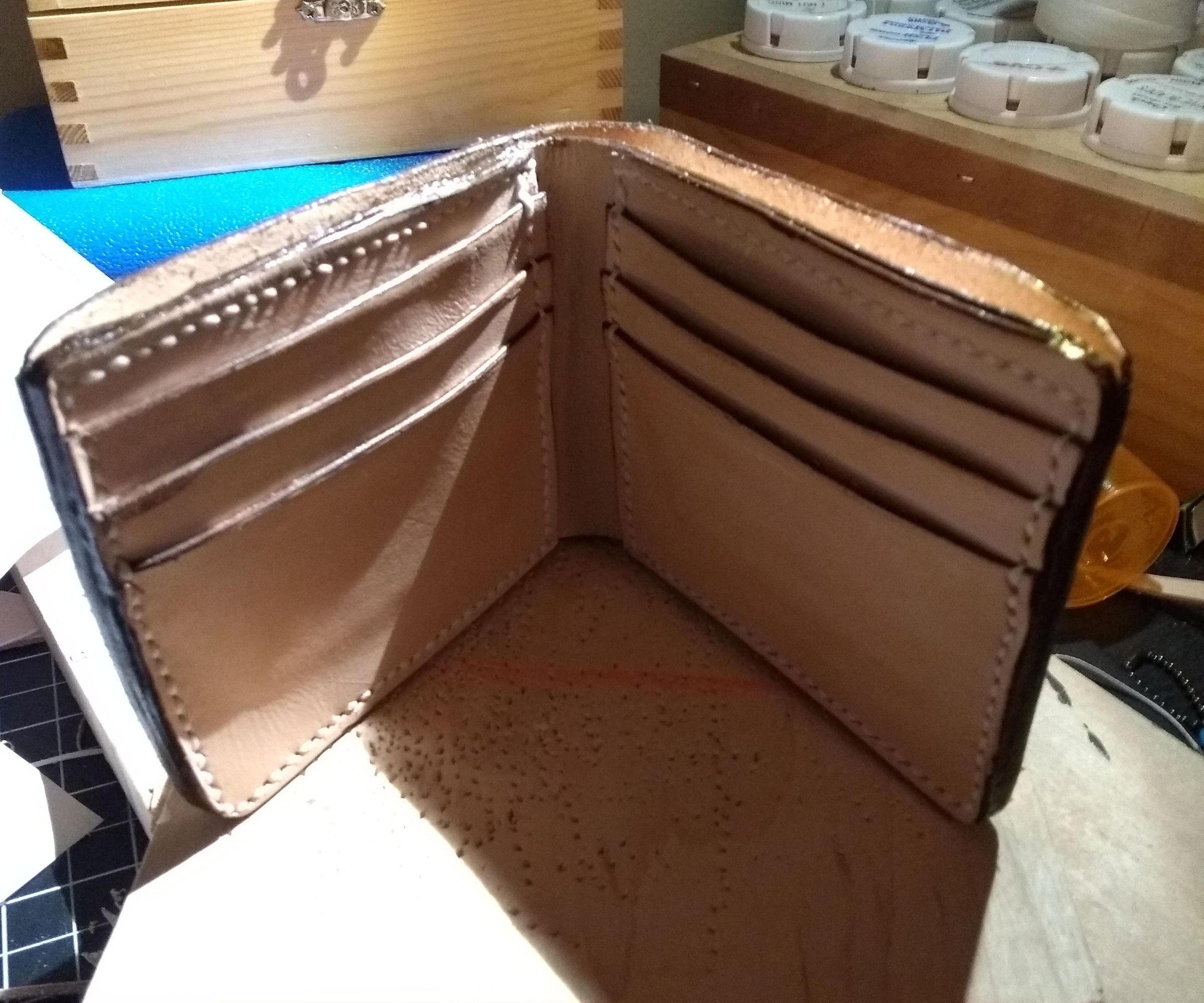

Step 1: Leather Pieces
Cut out your pattern from the paper and then transfer it to the leather using the scratch awl and then cut the individual pieces out.
Step 2: Dying the Leather
Using a wool dauber apply the dye to the leather and make it as even as possible.
Step 3: Skiving the Edges Down
Personally if I was to do this again, I would probably have used 2-3 oz leather but I realized that that these edges would be hard to punch through with my stitching chisels so I skived down all the edges and they ended up being pretty nice.
Step 4: Gluing
The first thing your going to glue are the two big pockets together. Just make sure not to glue the tops of each so that there is a pocket in the middle. Then glue the remaining card slots on the two sides.
Step 5: Stitching
The next step is to punch your stitching holes and then stitch the wallet together.
Step 6: Neatsfoot Oil
I used a wool dauber to apply some neatsfoot oil to give it a rich color. The trick is experimenting on leather beforehand so that you don't make it too oily but give it enough also.
