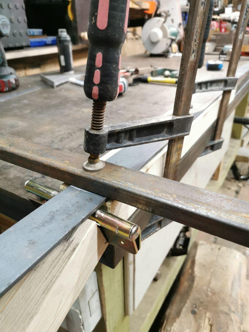

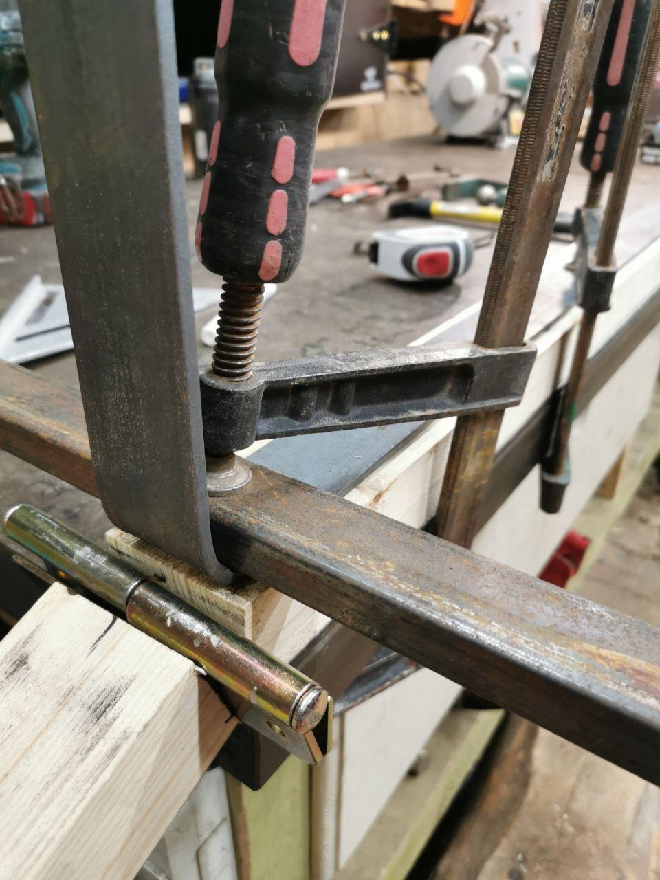

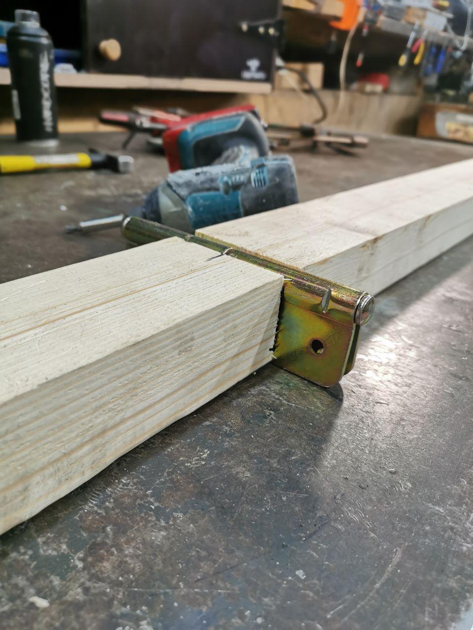

Step 2: The Jig
The first thing I did was to build the jig. It is by far the easiest jig I have ever built consisting of just 2X4 lumber and a hinge. I cut the 2X4 int two pieces and just screwed the hinge on like shown in the photo. As simple as that. It is important that the top face is completely flat and parallel. Otherwise, the bends come out crooked.
The hinge that I used was one of those door hinges that slide apart. It was definitely not the best idea as the hinge started bending as well.
Step 3: Bending

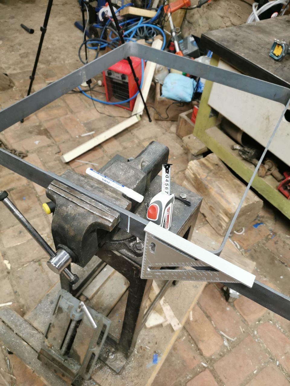

Then I just made the bends. I marked the desired bend location and clamped the flat bar down. As you can see I also used a little piece of metal near the bend (has to be perpendicular) to clamp it down better. Then I just used some muscle power. I just eyeballed the angle then checked and corrected it by using a little speed square. I repeated this step 4 times till I had a square.
Step 4: Cutting
Then I just clamped the square in a vice and cut off the excess with an angle grinder. When clamping it to the vice it is important to check that the width of the bottom matches the width on the top.

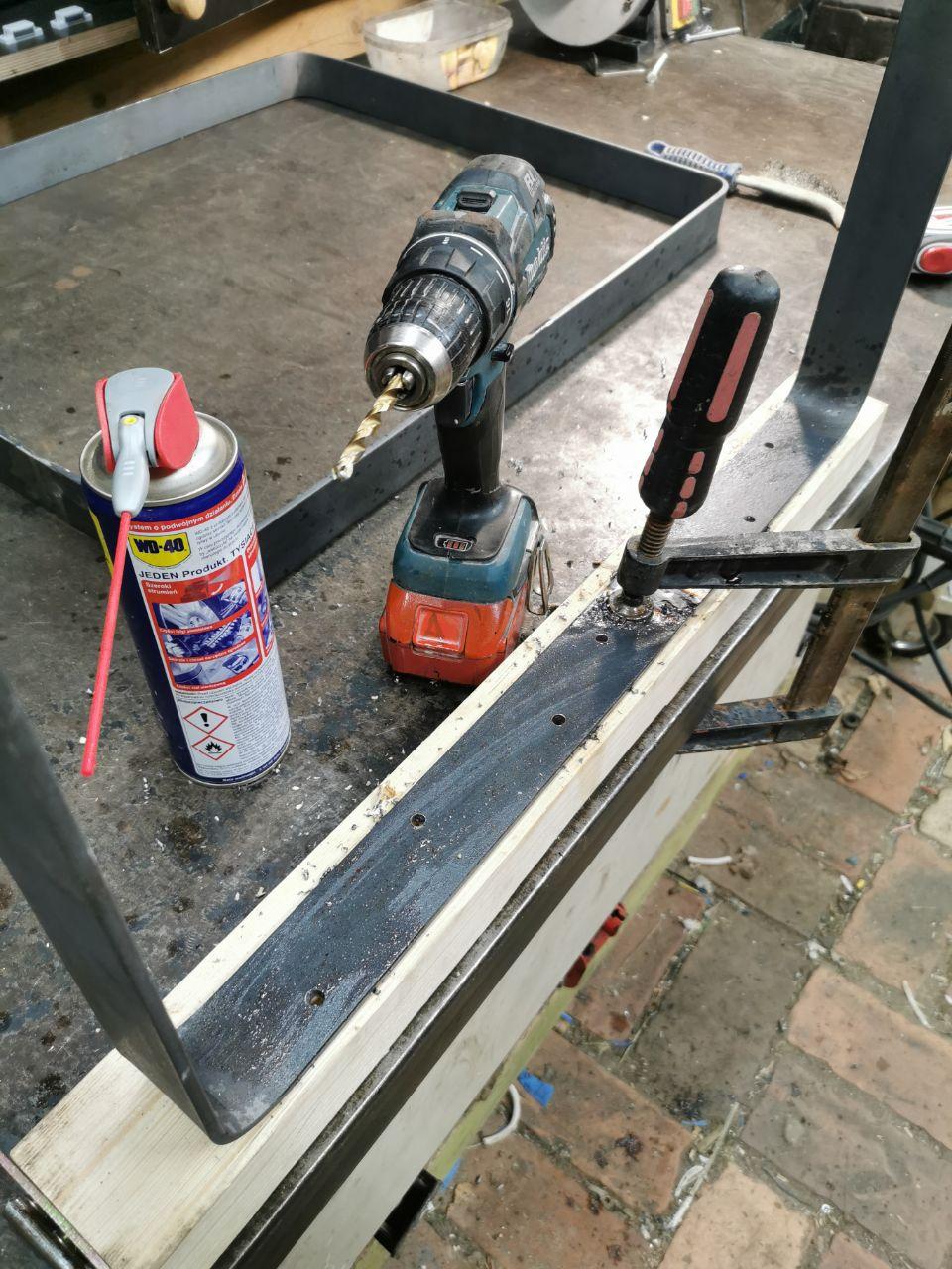

Step 5: Welding and Drilling
I am not 100% sure but I think you do not need to weld the two ends together. When the leg gets properly screwed to the table it probably fixes it in place just as well. As I had a welder at the spot I just welded it to be extra sure.
Then it was just a matter of drilling the holes. I actually managed to break 2 or 3 bits as the ones I used were really brittle.

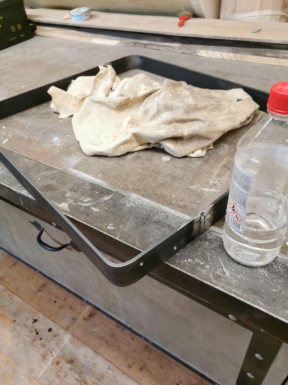

Step 6: Paint
And the last thing to do before attaching was to paint them. I just used rattle can paint. One coat of primer and two coats of matte black. Pretty happy with the results.
Do not forget to clean the surface with mineral spirit before painting to remove oil and dust ;)
After attaching the legs I found that the vertical sides had a little bend in them (towards the outside). To fix that issue I just ratchet strap to pull them together and make parallel.
