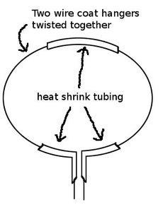

First we need to make a wire hoop to fasten the freezer pop net bag to. Take two wire coat hangers and straighten them the best you can. Then twist them together. I used two, three might have produced a more solid hoop but would have been more difficult to work with.
Then slide a piece of 3/16" heat shrink tubing onto the middle and the two ends. Use a soldering iron to shrink it up. This was so I knew where the middle was and to keep the coat hangers twisted together. I used some 5-6 inch sections of heat shrink tubing on both ends of the twisted wire clothes hangers.

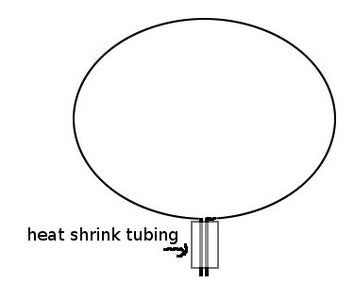

Now with this piece, you want to make a hoop that will hold the bag open but not be too big or two small for the bag. I made a rough circle with the coat hangers, put it in the bag, then opened it up as best I could without the bag slipping off. It's best to have a second set of hands help you with this part. Mark the spot where the wires meet up, then bend them straight out. This is the part you will insert into the handle.
Take some 3/8" heat shrink tubing and shrink it around the two ends of the hoop to keep the two halves together.

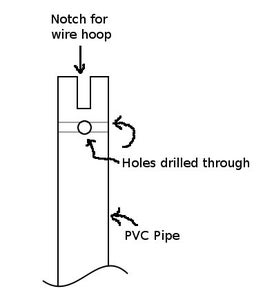

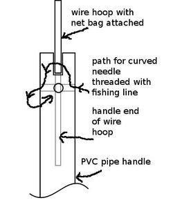

Step 3: Make the Handle
Make a notch in the end of the PVC pipe you will be using for your handle. This is to keep the net from spinning around in the handle. I used the saw on my Leatherman then used the knife to widen it up a bit.
Drill two holes 90 degrees from each other straight through the PVC pipe about 1/2 inch from the end. So you end up with 4 holes all together. We'll be using these holes to attach the wire hoop with net to the handle, in the next step.
Step 4: Attach the Wire Hoop to the Handle.

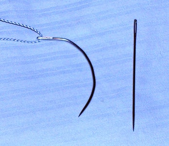

In order to get the needle through the holes and up through the top of the pvc pipe I had to bend it into a half circle. I used two Leatherman's to do this. Ok so I have a bit of a Leatherman problem, I have 5 of them. But it's not my fault, they keep coming out with newer better ones. The Charge TTI (Titanium...mmmmmmmm!) has me drooling so I'm saving up for it.
So anyway I used one Leatherman to hold the back of the needle (with the pliers), the other to slightly bend it. Then I slid both down a bit and repeated this process until I had a nice curve to it.
Once this was done I could thread the needle then stuck the needle through one of the holes in the PVC up through the top, then through the net, then back down the neck and through the opposite hole. I repeated this step several times until the net was secure to the handle and then tied off the fishing line.

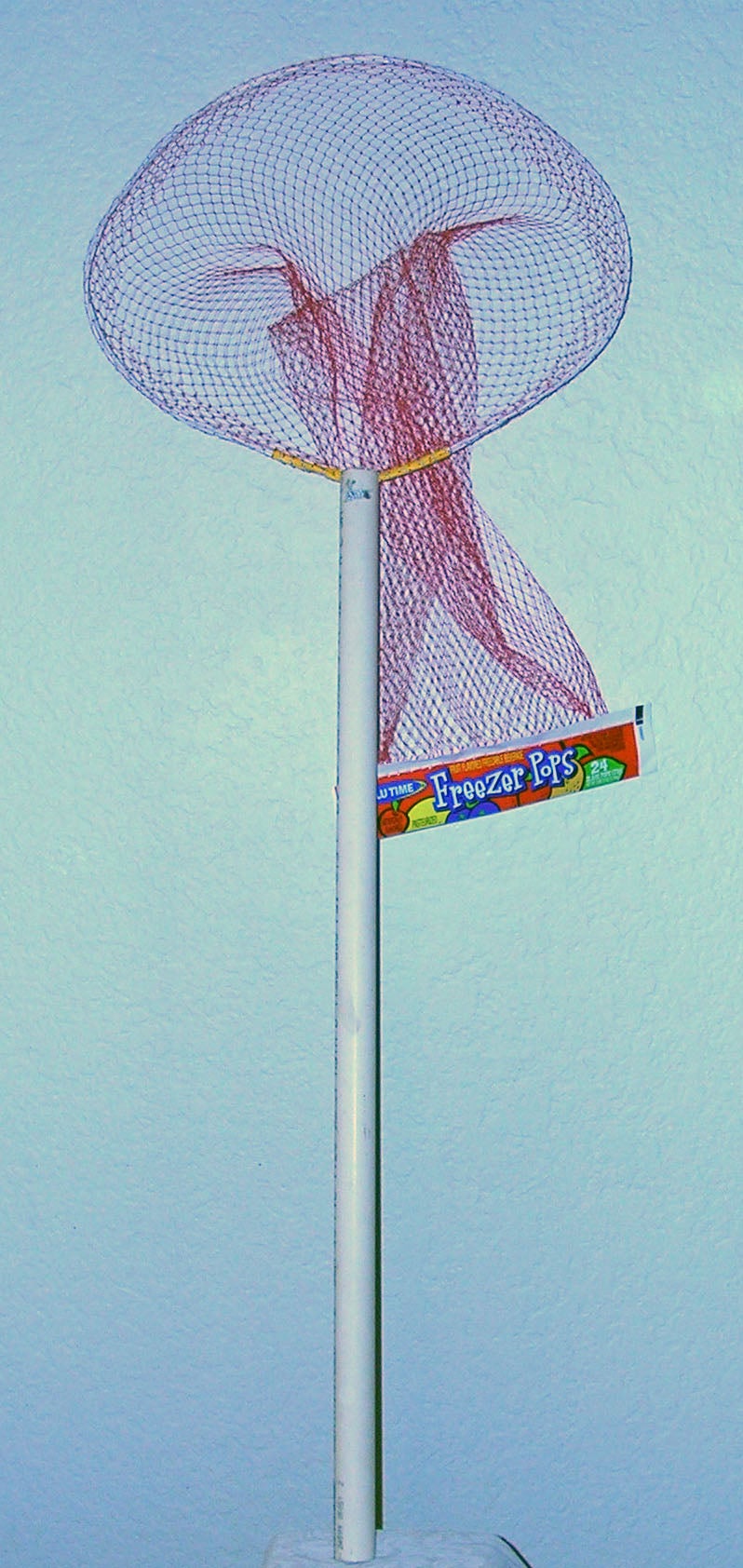

And there you have a complete minnow net!

So the wife and I took this little baby out fishing with us. With it we caught minnows for bait but the star of the show was using it to catch crayfish. The wife caught 3 dozen crayfish with it and it was a whole meal for us the next day! So saving some silly parts that you'd normally throw away paid for a whole gourmet meal! Now how cool is that??

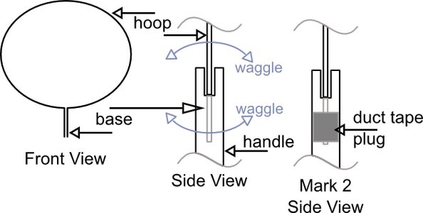

The Duct Tape Plug:
Ok the original had just a bit of waggle in it, not enough to bother most people but it bugged me enough to remedy the situation in the Mark 2. To solve the issue, I simply wrapped a strip of Duct Tape around the wire base of the hoop until I had a cylindrical plug just big enough to snuggly fit in the pvc handle. This completely removed the waggle.

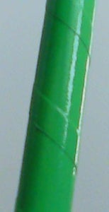

Handle Upgrades:
The last upgrade to the Mark 2 was the addition of neon green duct tape spirally covering the handle. The duct tape is replaceable for when it wears out. The neon green color is to make it easier to see when you put it down. I did this instead of painting the handle because the duct tape was cheaper and easier than a can of spray paint and clear coat. Plus it's Duct Tape, come on! Maybe I can enter this project in a duct tape related contest in the future.

The Duct Tape Plug:

Handle Upgrades:
