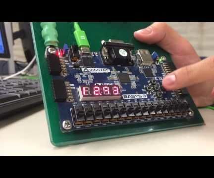

Introduction: Mirror Display
The goal of this project is to create the image display functionality of a Smart Mirror. The mirror is able to display forecasts (sunny, partly sunny, cloudy, windy, rain, thunder, and snow) and temperature values from -9999° to 9999°. Forecast and temperature values are hard coded as if to emulate them being parsed from a weather API.
The project uses a Zynq-Zybo-7000 board running FreeRTOS and uses Vivado 2018.2 to design and program the hardware.

Add two GPIO blocks to the Block Design. The GPIOs will be used to control the pixel address and the RGB components of the pixels. Configure the blocks as shown in the images above. Once you add and configure both blocks then click "Run Connection Automation."
GPIO 0 - Channel 1 controls the pixel address and Channel 2 controls the red color.
GPIO 1 - Channel 1 controls the green color and Channel 2 controls the blue color.
