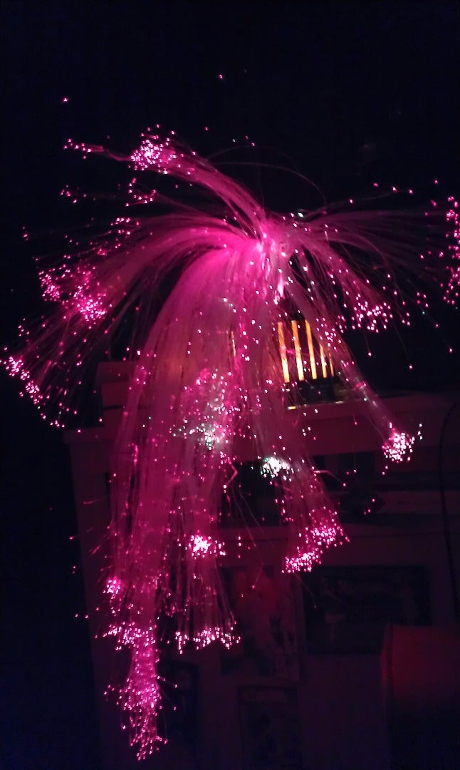

Optic fibres:
You can use either a christmas tree and/or a UFO-lamp. I found my tree at a fleamarket for 5 euros and bought some cheap UFOlamps, because I wanted a big map and the tree was just a bit too small to cover the whole surface.

Step 2: Stripping the Tree
This, ladies and gentlemen, is nót a fun thing to do. It takes a LOT of time and will drive you slightly mad, but all for a good cause ofcourse. The trick was to start at the bottom and work your way up. I used this http://www.atelier-yvonne.nl/images/tornmesje.jpg little tool to strip the tree, very useful! (According to google translate it's called a seam stripper).
Eventually you'll only have the optic fibres left!

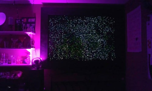

As you can see, because of screwing up, the black spay painted lines are also on the back side and also the right hand corner is missing a layer since the velcro was a bit more sticky than I thought. First I poked the ufolamps in each corner (don't really know why, just started somewhere) and than it's just a matter of (again), poking and poking and poking (and watching netflix) and poking.. The advantage of the velcro was that the needle-poked-hole stayed 'open', but shrunk just a tiny bit, which made it annoying to guide the fibres through, but once through they stayed where they were! No glue needed!
I removed the paper with the stars because the holes were visible on the foamboard.
Don't cut the fibres just yet! Just leave them like that until the very last phase.
As you can see in the last picture, it looks so cool! Some stars are brighter than others because of the bundled LEDs and different sizes fibre.

The foamboard was put in the frame and fastened with a few cubes made out of wood, scewed to the inner frame.
The LED's were bundled together with tiewraps and duct tape and fastened to the optic fibre bundles using the same materials. There were some LEDS unused, but I just let them dangle there. MrTrick covered the back due to light leakage, but I didn't. Again, personal choice. If i'm ever going to move it, then it might be a good idea to protect the fibres that way.
Last step, cut off the fibres, hang on the wall and stare in awe to the beautiful artpiece you've created!
