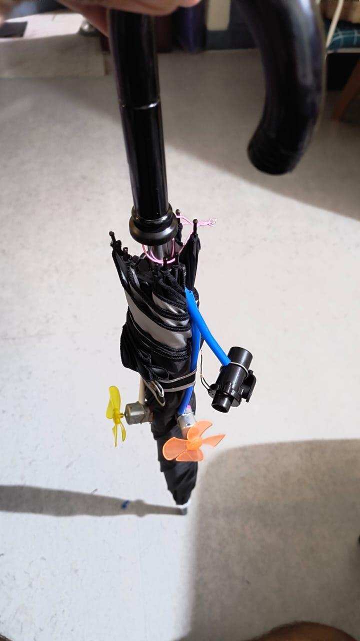

Step 1: Making the Frame for Fans and Mist Generator
The frame is made using metal wire, Plastic pipe cover and a small box that is used to attach the whole setup to the umbrella as shown in the pictures.
Wrap the metal wire around the motor and twist it to attach to the wire. Now insert the plastic pipe over the metal wire and pass the motor wire through the pipe as shown in picture do the same with the second motor fand and the mist generator. Attach the other end of these three setup (Two motor fan and One Mist generator) to the small box by wrapping the wire around it Your frame for fand and missed generator is ready.

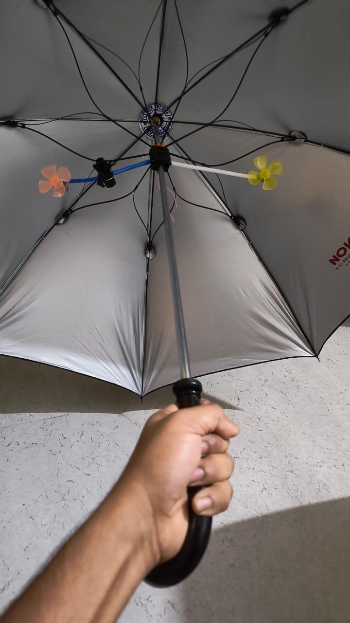

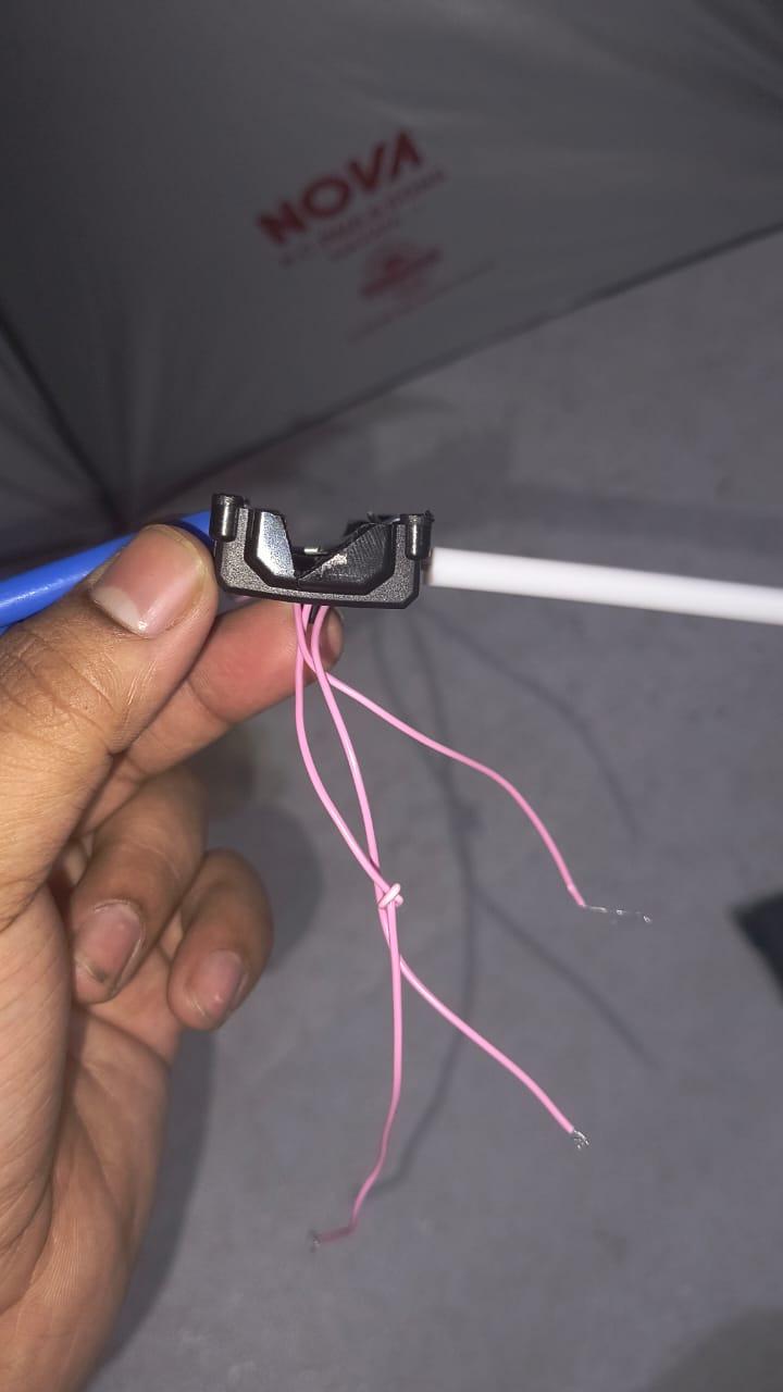

Step 2: Attaching the Fans and Mist Generator to the Umbrella
Cut slots in the middle of the small box as shown in picture for attaching to the umbrella Shaft. Now the whole setup is attach to the umbrella by fixing the box using screws as shown in picture.

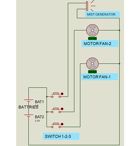

Step 3: Designing the Power Source and Connections
For the powering the fan and mist generator, A module with three switch is designed. Two 3.3V batteries are connected in series the positive end is connected to one terminal of each three switch, The other terminal of all the three switch is connected to one terminals of two motor and one mist generator. The negative terminal of the battery is connected to the other terminal of two motors and mist generator. The whole setup is boxed inside a plastic box as shown. Refer to Circuit diagram for more information.
Step 4: Testing - Let's Go Outside !
The design will look like as shown in picture, Fill some water in mist generator, plugin your batteries you are all set to roam the hot outside, just turn on your supply of mist-infused air under your umbrella.
