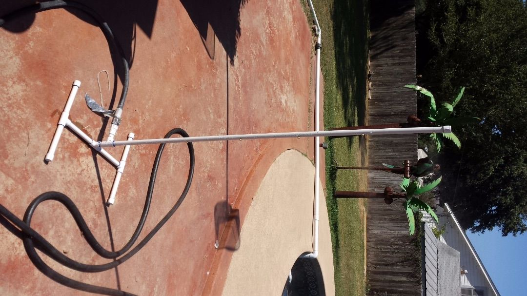

Step 2: Let's Get Drilling!
First, take your 58-1/2" pipe (remember you had to cut a 1-1/2" piece off of it?) and mark a straight line down the edge of it. The easiest way I have found to do this is to set it into a door jamb and trace a straight line along the jamb. Place 5 marks on it, spaced every 10" starting from the top. This will be the location of 5 of the 6 mister heads, the last one will go in the top cap.
Now, using the 5/32" drill bit, drill a hole at each of your marks and one in the top cap. You only want to drill through one side of the PVC, not through both sides. Finally, drill a 5/16" hole in the bottom cap.

Step 4: Assembly
Gather your parts for the base assembly and break out the PVC primer and glue. Glue the 1-1/2" connector to the stake assembly, then glue that piece to the tee. Now you can screw the hose adapter to the tee as well. I used a little bit of Teflon tape to help lubricate the threads and provide a better seal, your decision. Its not like this thing isn't designed to throw water all over, so I doubt a little leak in the threads would matter, it just helped screw in the adapter.
Next glue the pipe to the other end of the tee and the top cap to the far end. Remember the end you measured from is the top since the bottom measurement is a little shorter due to cutting off the connector.
Now its just a matter of screwing the mist heads in the 5/32" holes you drilled! The heads will groove their own threads, just don't push them too far or they will strip. If the hole is a little to big, you can wrap the threads with some Teflon tape to fill in the gap. While it looks nice to have all the heads facing the same way, it functions perfectly if they are in all directions, so don't force it when you turn them!
Step 5: Let's Try This Thing Out!
OK, all the heads are in and the glue is drying, time to clean up the mess and hook this up.
The Mistick, built as shown, puts out a large mist plume and a good amount of water per hour, so you can plant it pretty far away from you and your guests and cool off a large area. High winds are no match for the Mistick!
When you put it in the ground, push it down from the 5' pipe, not from the tee or hose connection.
