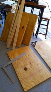

Step 1:
Unloading the wood after a trip to Lowe’s.
Step 2:
Measure the height of the saw to the base to ensure a level cutting plane.

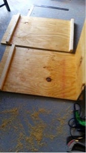

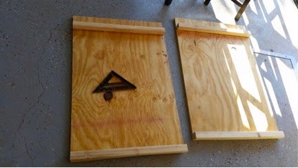

Step 3:
Laying out the 2x2 pieces that act as shelf support for the top and bottom of the cart.

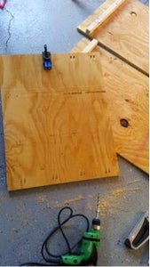

Step 4:
Going crazy with the pocket screw jig. (You don’t need this many pocket screws. I just got my Kreg R3 Jr. Pocket Hole Jig System and was just having a good ole’ time.

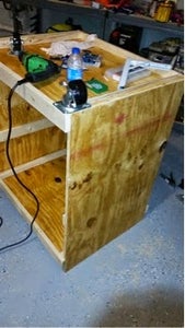

Step 5:
Now attaching the base and top shelf.

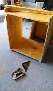

Step 6:
Finally attaching the 1x3 support boards to complete the actual cabinet.
This cart has a huge opening. It’s actually designed for
a much larger miter saw. So I decided to add additional shelving. A girl could never have too much storage.

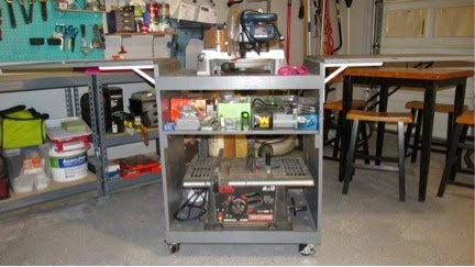

Step 9:
Tah- Dah!!!!
