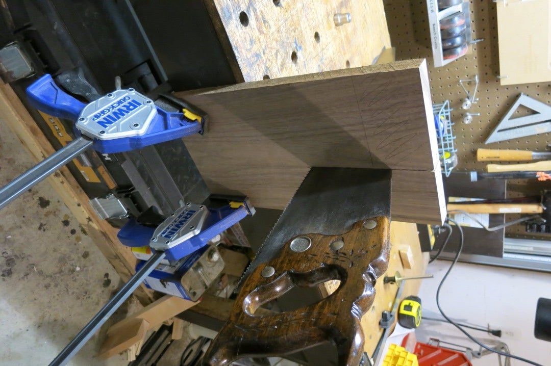

Mark one end on all sides with a combination square to make a 45 degree cut. Use a miter box or stand the board on your bench and saw through it, keeping to the outside edge of the lines you’ve marked. If you’re right on target, give yourself a gold star. If not, don’t worry, I didn’t do much better. Time to clean up the edge.
To make things easier, you’ll need a jig, aka block of wood cut at 45 degrees. Clamp it to the top of the board with the leading edge at the line you marked before. Let a chisel ride on the guide and with a steep, slicing motion, pare away the angled edge until it is even and smooth.

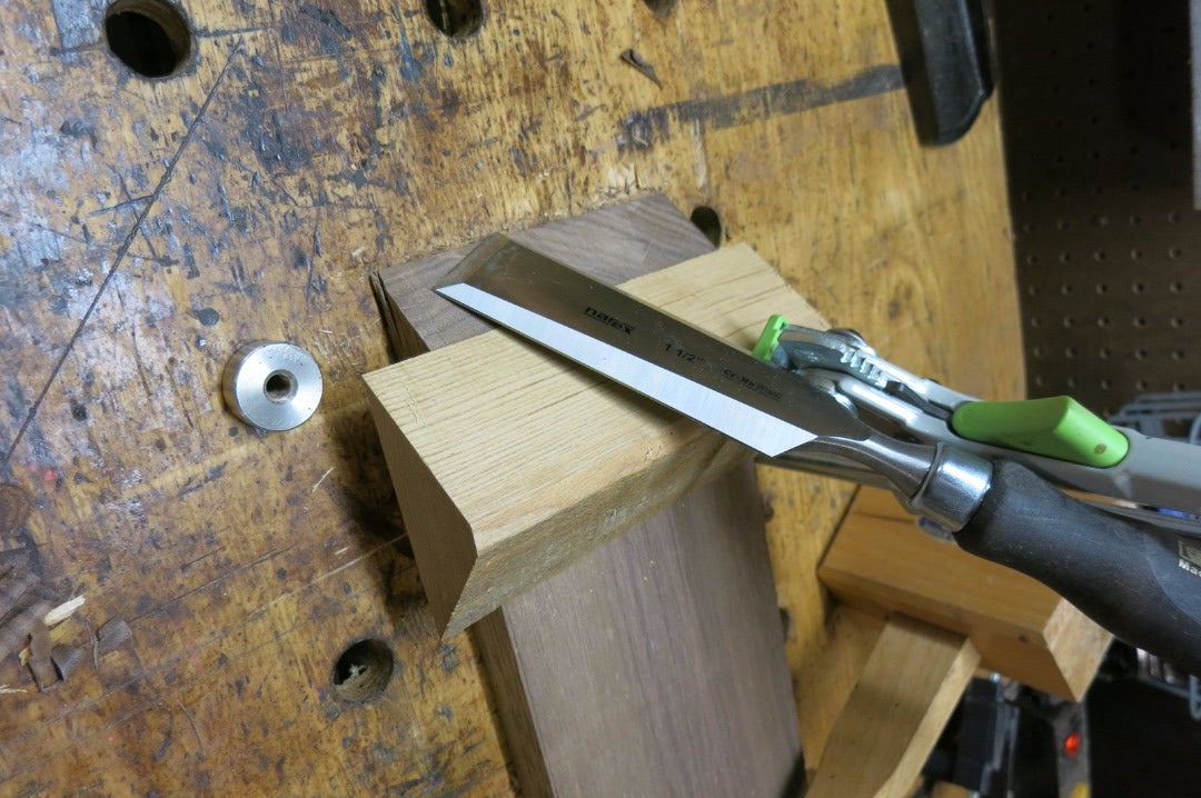

On the ends, I clamped my 45 degree block in place and used a paring chisel to slice away the remaining material. Going about 1/8” at a time went fairly well as you can see in the video. I finished up by planing all three edges with my restored #7 Stanley.
