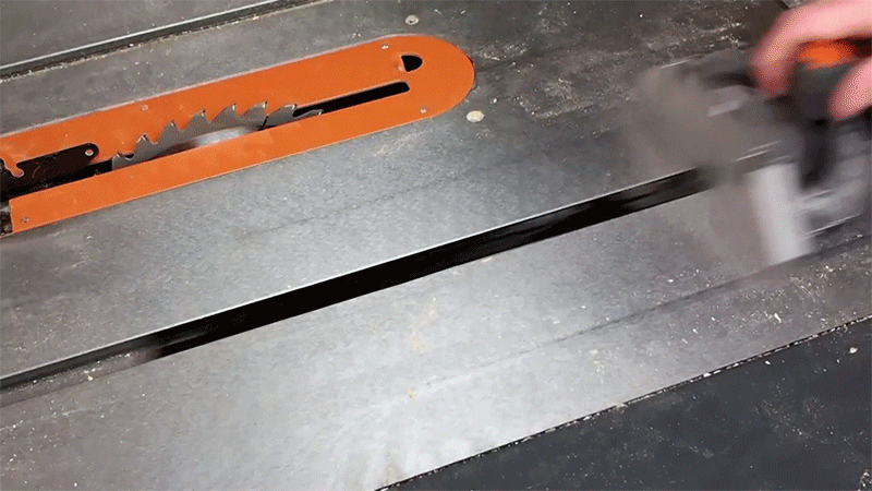

The mitre gauge can fit into either mitre track, depending on the cut. The material to be cut sits in front of the gauge and the mitre gauge slides along the track until the material makes contact with the blade, pushing through past the blade to complete the cut.

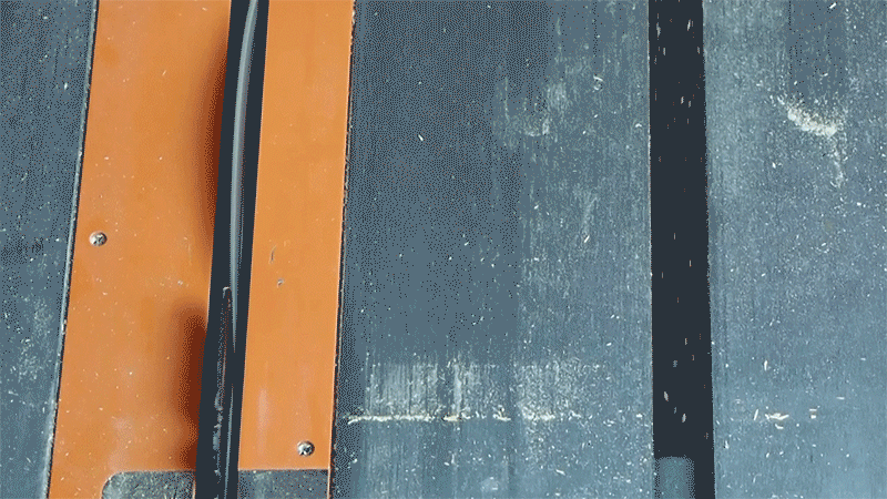

Before making any cuts it's a good idea to try sliding the mitre gauge along the entirety of the track to make sure there's no snags. The gauge should fit snugly and slide smoothly, with no slop between the mitre and the track.
Clean the mitre track from any debris, and if there are any sticking spots try adding a little paste wax in the mitre track to lubricate. You only need a very small amount of wax to lubricate, you shouldn't be able to see the wax if applied properly.

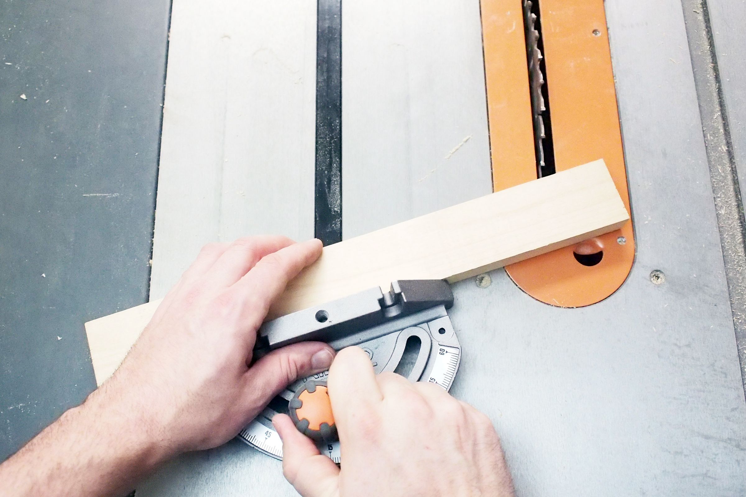

There's a track on either side of the blade which allows the mitre gauge to change places, depending on the angle of the cut you want to make. When setting up your mitre to make a cut, pay attention to how your piece rests on the gauge. You want to have your work trailing the mitre, not leading it.
Take a look at the picture above - the wood is angled so that the material is trailing the mitre. Now take a look at the picture below, the wood is angled to lead the mitre gauge.
Don't lead with the material, lead with the mitre gauge.

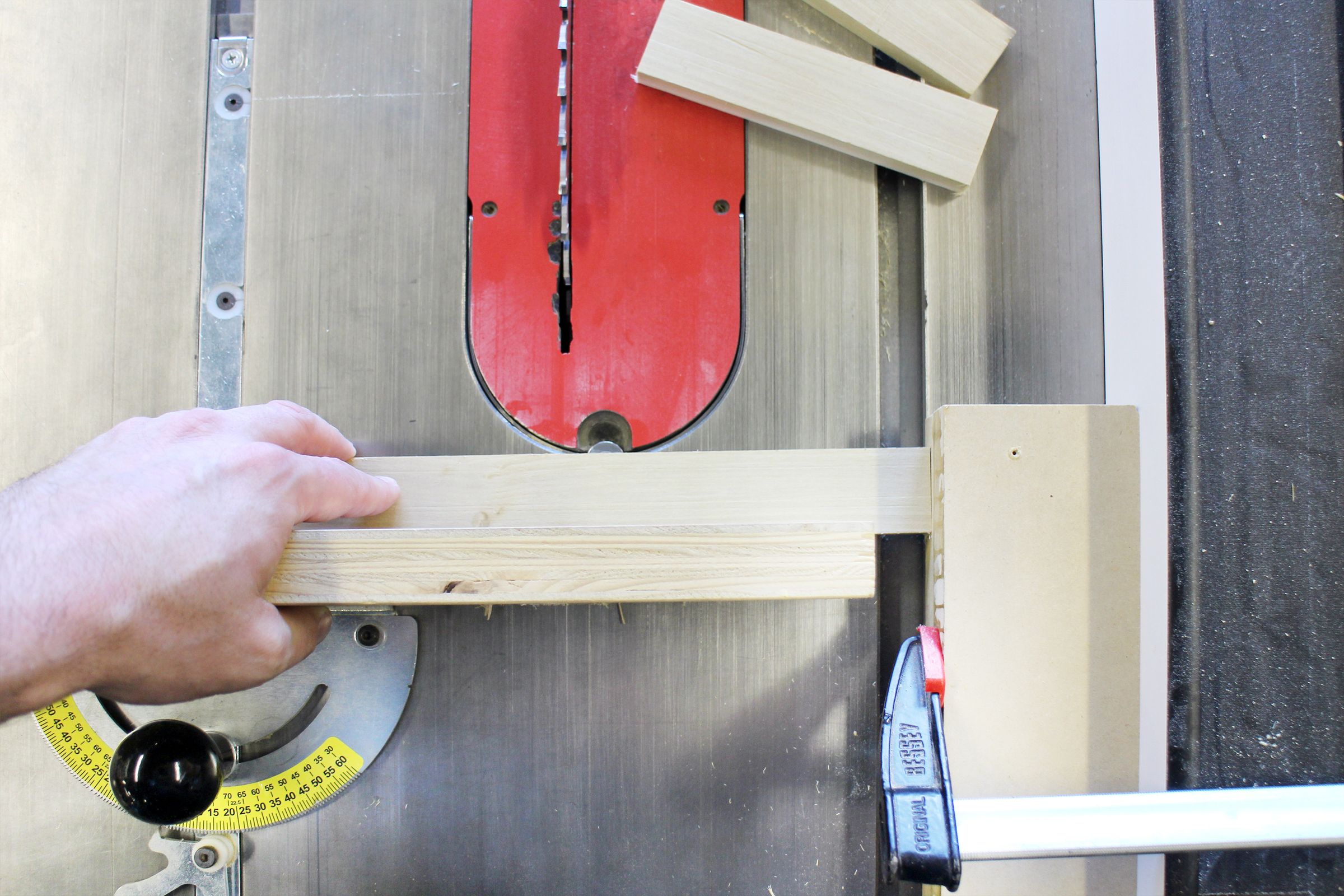

Remember when I said to never use the fence when making mitre cuts? Well, this is the only time you're allowed to break that rule. The fence can be an incredibly helpful measurement tool when making repetitive cuts with the mitre gauge, but not how you're used to using it when ripping wood.
A scrap, square piece of wood can be clamped to the fence and used as a stopping block a measured distance away from the blade. What's important is that the stop block be set far enough back so that it doesn't interfere with the saw blade or fence when the mitre gauge is moved forward.
In the above image the top arrow shows the desired length I want my cuts to be, from the stop block to the saw blade is 5½". The lower arrow shows that the mitre gauge can move freely and not get caught up with the stop block. Also note, the stop block is set back enough to allow the wood being cut an unencumbered path during and after the cut. This will prevent any kickback from occurring.
Place the wood in the mitre gauge and slide it to the stop block. Turn on saw and firmly hold the wood to the mitre gauge and slide the wood through the blade completely to make the cut.
Once you have your stop block and fence dialed in, you can easily make many repetitive cuts with the mitre gauge. This is much faster than measuring each cut and accounting for kerf, especially if you have lots of the same cut to make.

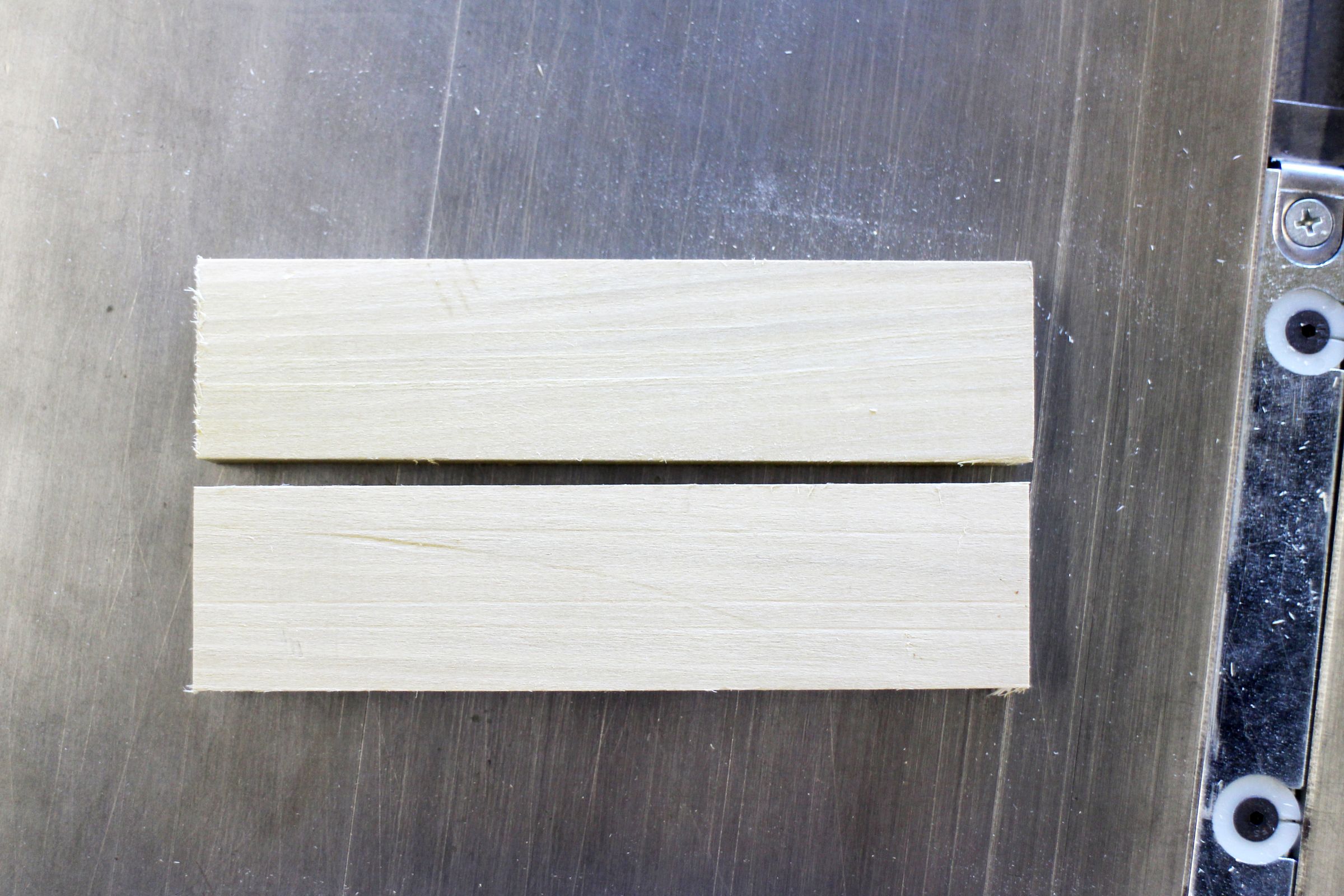

Identical length cuts, thanks to a stop block and the mitre gauge.
