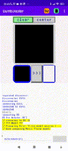

DumbDisplay will be used as the UI driven by the ESP32 / ESP32S3 microcontroller, for both getting handwriting input from you, as well as displaying the recognition result.
Hopefully, the UI should be obviously enough
- You draw a digit to be recognized on the big black square canvas
- You clear what is drawn by clicking the "clear" button on the top-left side
- The "center" option on the top-right side is for auto-centering the handwritten digit (so that recognition can be more accurate)
- You trigger recognition by clicking the ">>>" button on the middle-bottom side.
- After recognition, the handwritten digit will be transferred to the smaller black square canvas on the left-bottom side.
- And the recognition result digit will be shown on the right-bottom side.

In the setup block. First, DumbDisplay is configured.
drawLayer = dumbdisplay.createGraphicalLayer(28, 28);
drawLayer->border(1, "lightgray", "round", 0.5);
drawLayer->enableFeedback("fs:drag");
copyLayer = dumbdisplay.createGraphicalLayer(28, 28);
clearBtn = dumbdisplay.createLcdLayer(7, 1);
centerBtn = dumbdisplay.createLcdLayer(8, 1);
inferenceBtn = dumbdisplay.createLcdLayer(3, 3);
resultLayer = dumbdisplay.create7SegmentRowLayer();
dumbdisplay.configAutoPin(
DDAutoPinConfig('V')
.build()
// set "idle callback restart ESP32 if idle (i.e. disconnected)
dumbdisplay.setIdleCalback([](long idleForMillis) {
ESP.restart(); // restart ESP32 if idle (i.e. disconnected)
- drawLayer is a GraphicalDDLayer layer that acts as input for the digit to recognize; you drag to draw on the layer's big black canvas; notice that the layer has "feedback" enabled with the "drag" option, which basically enables sending drag movements back to the layer as "feedbacks"
- copyLayer is also a GraphicalDDLayer layer acting as the target to copy the handwritten digit after recognization
- clearBtn, centerBtn and inferenceBtn are LcdDDLayer layers that simulate various buttons of the UI
- result layer is a SevenSegmentRowDDLayer layer for showing the inference (recognition) result digit
- the different layers are "auto pinned" in the desired layout by calling dumbdisplay.configAutoPin()
- an "idle callback" is set up -- which is called when the connection between the microcontroller and the DumbDisplay app is lost -- to restart the ESP microcontroller when idle (disconnected)
