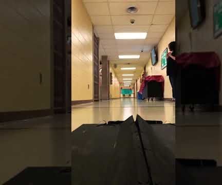

Introduction: Mobile Charge Cart
Teachers all face storage problems. We have been looking for a way to store and charge batteries for our robots in the classroom. Organization of batteries is a problem many engineering and robotics teachers encounter when storing items and taking them to competitions. Our project will eliminate the problem of space and create a functional way to carry batteries on the go.
NOTE: We used recycled and re-purposed materials from our Career and Technical Center due to time & budget constraints. Many steps and materials can be replaced in this project, so this does not need to be specifically built like ours. However, this guide will show you the steps to creating this miracle on wheels.

Step 8: If We Were to Make This Again.....
As stated earlier, we used completely recycled parts and 3D printed parts from our CTE center. When we revisit this project and make improvements we will make the following changes/adjustments:
- We will use plywood instead of the thin wood panels
- We will buy caster wheels and adapters instead of using recycled ones (3D printed adapter is not ideal for supporting the load - we used ABS filament)
- We will measure school bus doors to ensure we can load charging station onto the bus. If this size does not fit, we will scale down the charging station or make other modifications.
