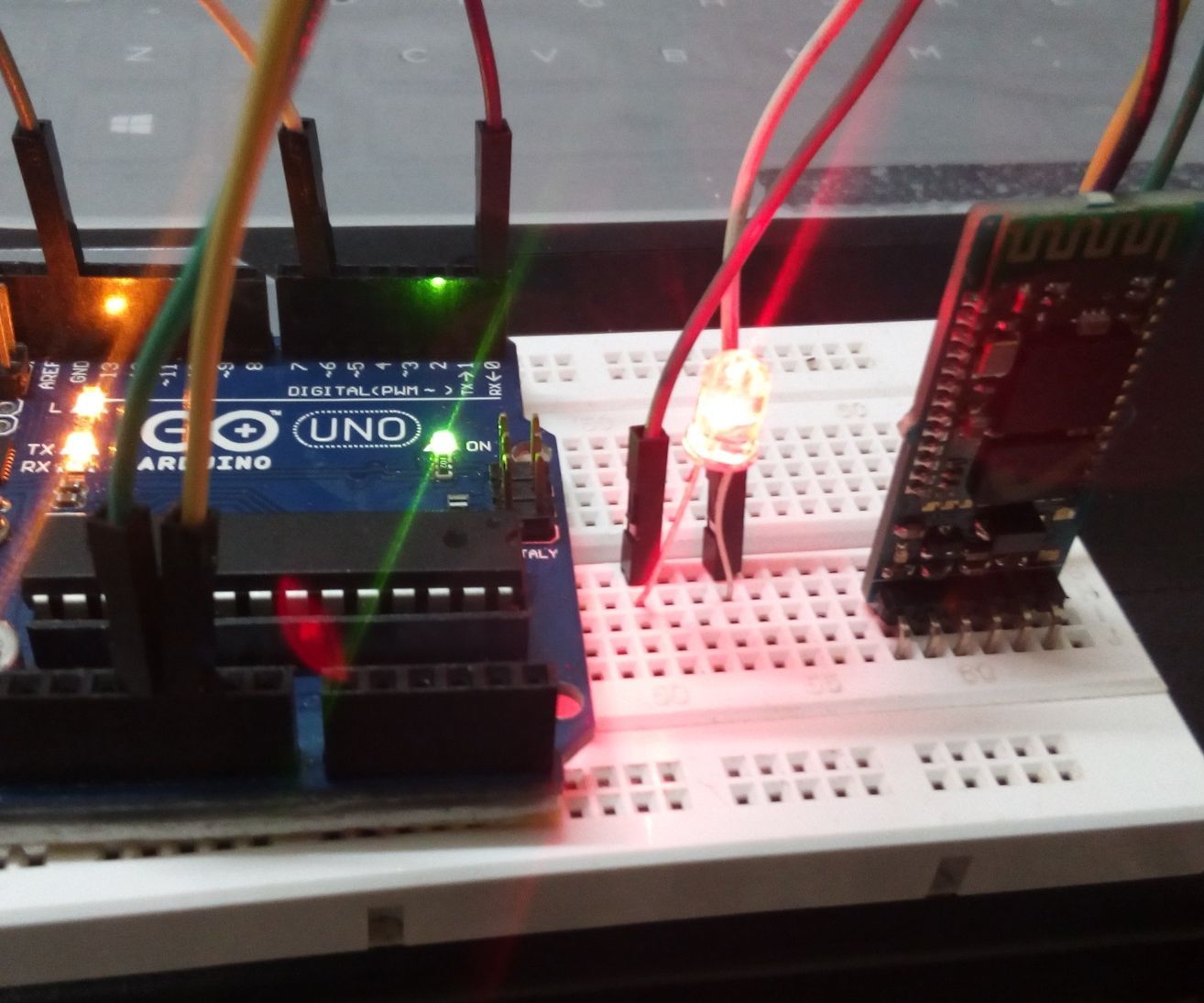

In this project i will show you how to make a android phone controlled car using Bluetooth module and Arduino Uno Board.
In this i also show you how to make android app for the same so that you can further change/modify it acc. to your needs.
Overall this project cover everything you need to build up a mobile controlled car(Hardware+coding).

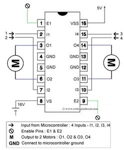

Step 3: Connections
Do connections as shown in figure above.
  • Here L293d is used because maximum output voltage of Arduino board is 5V. But we want more than 5V to run our Motors therefore we use L293D(Motor driver IC containing two H bridges) which can supply upto 32V to motors.
  • -To 8th pin of L293D ,you can provide voltage upto 32v ,depend on you how much speed of car you need...
Power Supply to Arduino and Motor
  • Adapter of required voltage can be used to power IC/Motors and separate 9V battery can be used to power Arduino Board
  • Please don't suppy Arduino Board more than 12V, it can burn out the the Board.
  • Paste any insulator(Double sided tap) below Arduino to prevent short circuiting.

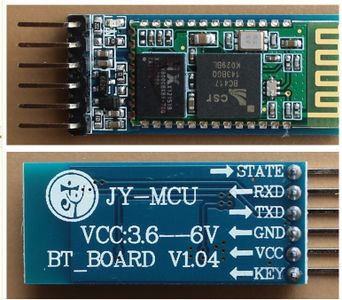

Bluetooth Module
  • Connection of VCC and GND of bluetooth module must be done with arduino 5V and GND.
  • connect TXD pin to RX pin of Arduino.

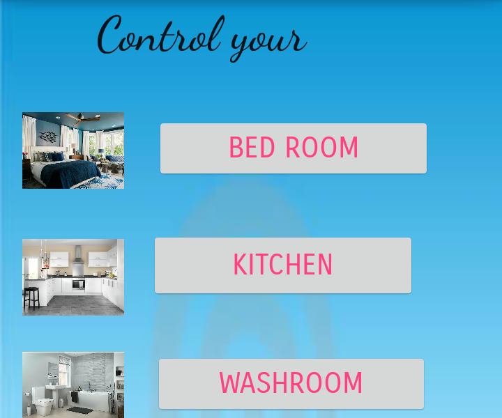

Step 5: Android App Code in Android Studio
This section for those who used Android Studio before...
New user can also use this code and modify it with help of tutorials on android studio...
Below link is given to download android files and apk file...
For Android Files(.rar):
https://drive.google.com/open?id=0B4eY-jcXDOueajhQT3BKMzYwdWM
For .apk file:
https://drive.google.com/open?id=0B4eY-jcXDOueRXU0...
Import android file(Bluetooth Control Car1) in android studio and enjoy editing...
