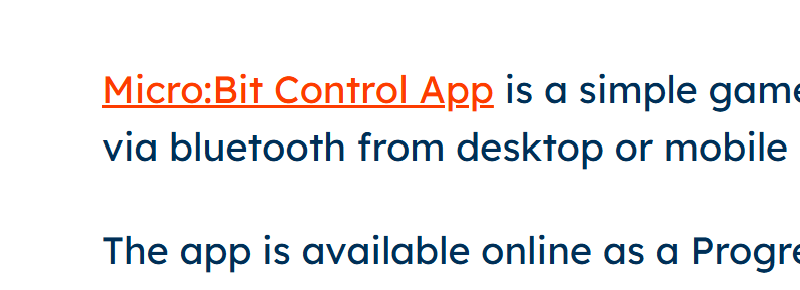

This is a Bluetooth conected robot so you will have to use a website to connect the device to the robot. The app that I chose was THE LOFI MICROBIT CONTROL app. Now let me show you how to work on it.
  1. Go on the link down
  2. It will take you to the LOFI app
  3. See the video
  4. Below the video there is a link, go on it
  5. It will take you to another tab
  6. On the tab click on the top right button that resembles a microbit
  7. Choose your Microbit Name
  8. Select and click on Done
  9. Use the arrow to move the robot in a specific direction you want it go in
  10. HAVE FUN!!!!
Link of the LOFI website
https://cardboard.lofirobot.com/microbit-control-app-info/
