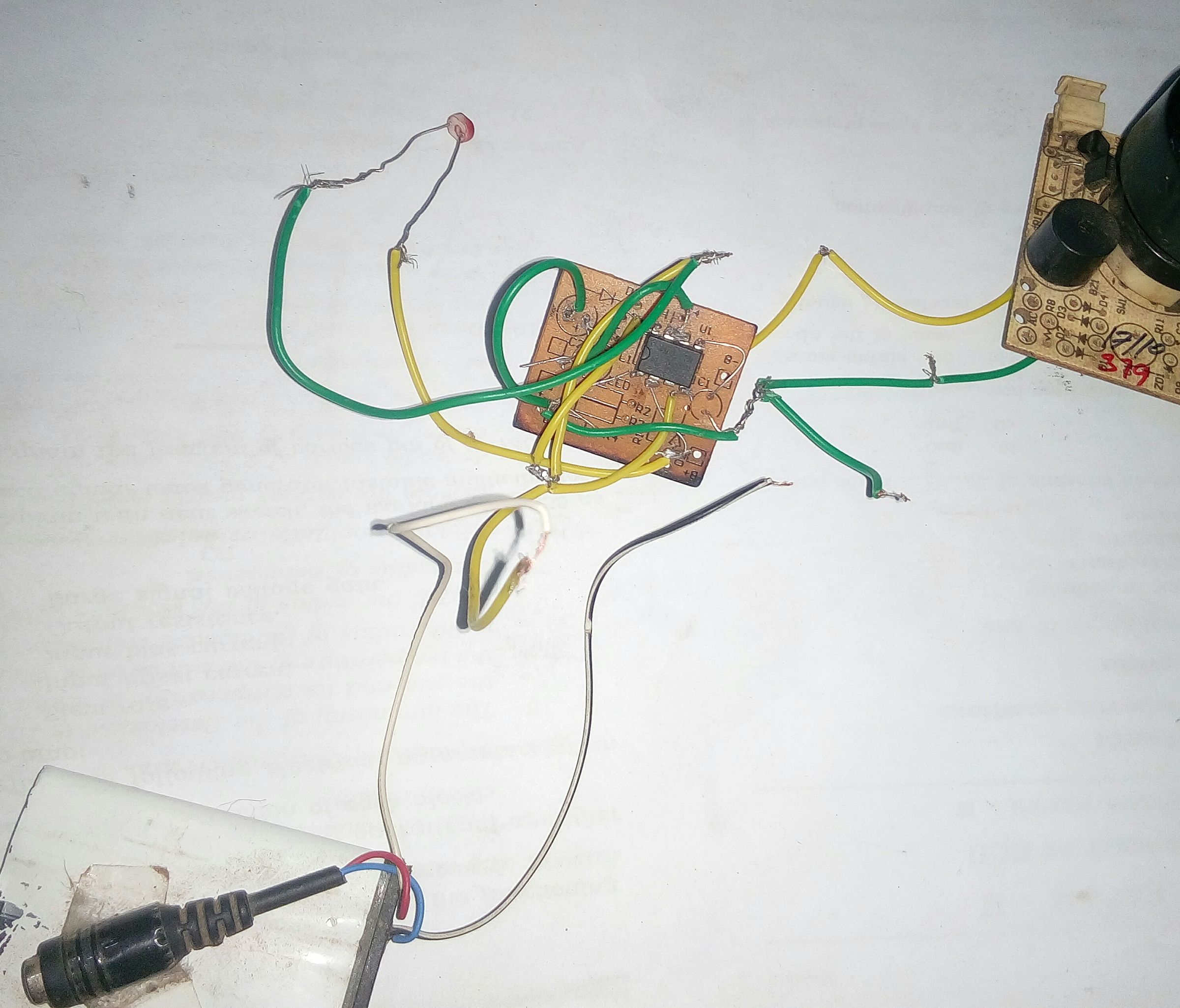

Step 2: Circuit
i have given circuit diagram . refer it and make on bread board or on pcb
connect tip and ring of universal headphone jack to ground . connect sleve of that to pin2 of dtmf ic followed by resistor and capacitor. its easy to make circuit connection by seeing diagram and i dont explain it in detail . if you have any problem please comment me
after completing circuit connection connect headphone jack to your mobile
