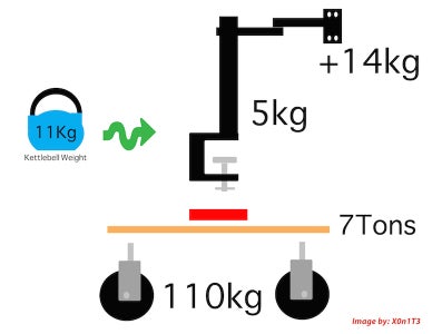

Step 1: So, in a Nutshell...
Let's start with the crazy fact: the bamboo chopping board has 3 layers and can withstand up to about 7 tons (according to the specs.) Talk about virtually indestructible... (at least for an office environment.)
The caster wheels are commercial grade and can withstand 110kg (~240 lbs) each wheel.
The LCD arm weights ~5kg and can support 14kg+ for the LCD...
I originally thought of having a 11kg kettlebell weight as a counter weight but it was not needed :)

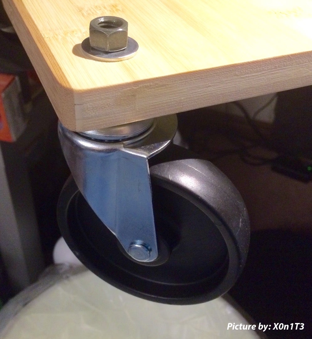

Step 3: Caster Wheels
The caster wheels have a 3/8 by 1 inch stem (approx.)
So, I had to find "rough" 3/8 nuts and washers. Thin lock nuts work too...
Always try on the nuts and washers to make sure they are the correct type...
Step 4: Assemble the Board With the Casters
Make sure you have:
caster wheel> washer> bamboo> washer> nut
The washers are there for support!
Make sure if your caster wheels have "locks" that these are at the front.
I had 2 people jump on this and it did not break...

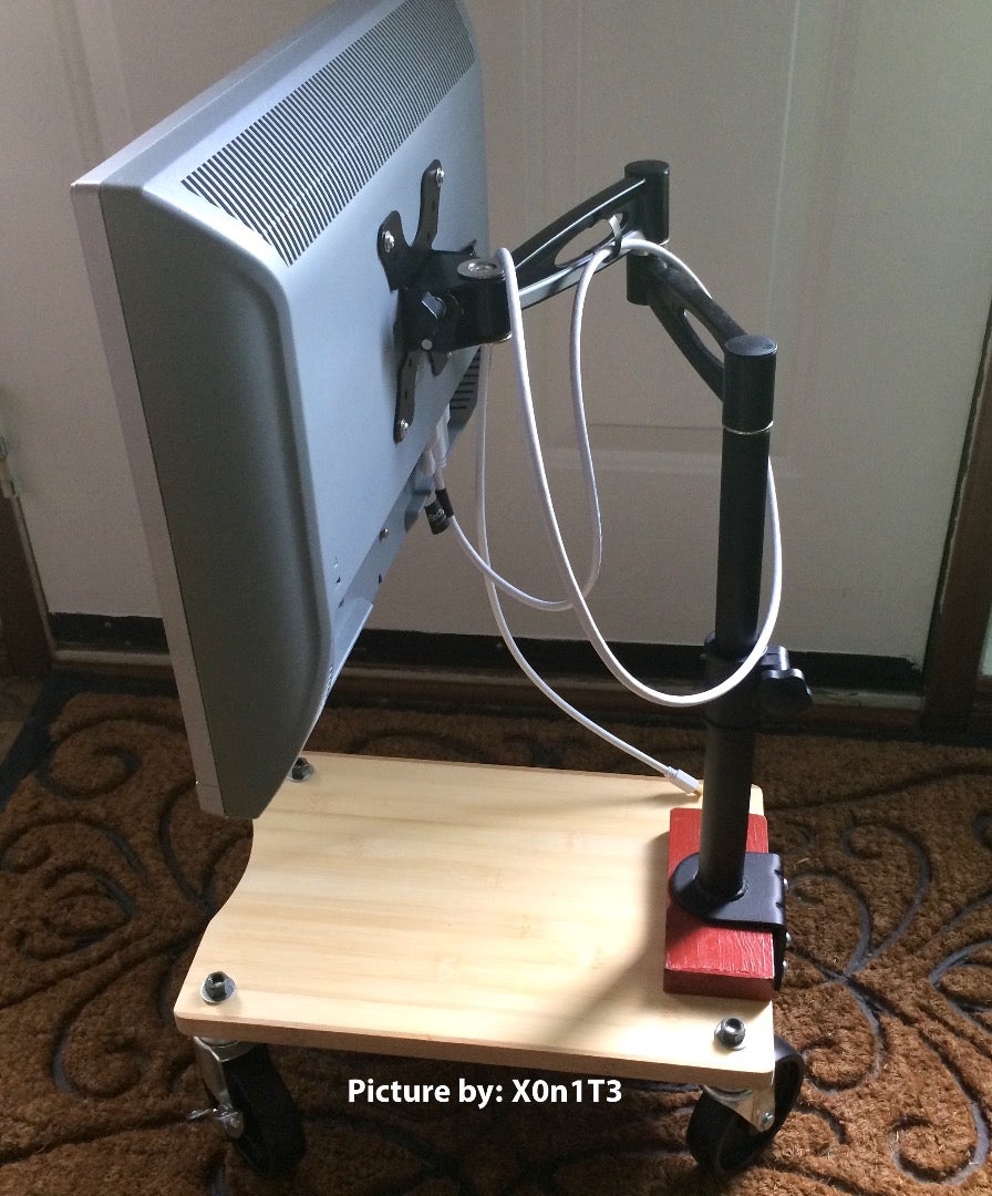

Step 5: Mount the LCD Arm
Before you do anything else, lock your wheels so that you do not have to chase it around the room.
I had to add some extra wood for the arm to fit properly and I also added some 5 min. epoxy to the nuts. (not needed)

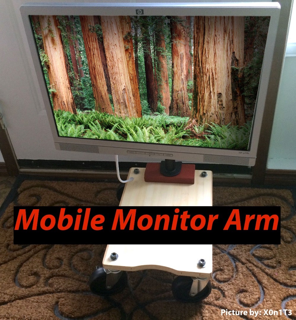

Step 6: Mount the LCD and You Are Done!
Mount the LCD monitor as per the LCD arm instructions and you are done!
You can move it around to wherever you need to have it and you can also take it with you.
