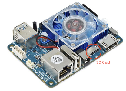

Step 2: Power Up Odroid XU4
Insert the micro SD card into Odroid XU4 after .img file is written on it, then power it up using the power supply.
If you are not using the official Odroid power supply, make sure the rating is 5V 4A. Note that the only way to power up the Odroid XU4 is via a barrel jack on the board.
The SD card slot is right next to this barrel jack connector.
After you power it up, your monitor should show a login prompt in terminal interface.
