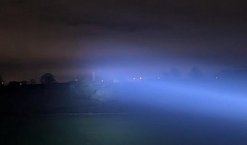

Depending on the diameter and power of your bulb it can have anywhere from 2-10km of range realistically. If you want to measure the range you will need a lux meter and ~20m of space but i won't cover that full process, you can find guides online like this thread https://www.reddit.com/r/flashlight/comments/wv0ucy/how_is_the_throw_measured/
Here's some photos of my testing, we got very lucky with heavy fog.
Since the build process really heavily depends on what parts you get its difficult to write a comprehensive guides. i have included some links to my build thread, some photos, and my youtube to help you along the way.
