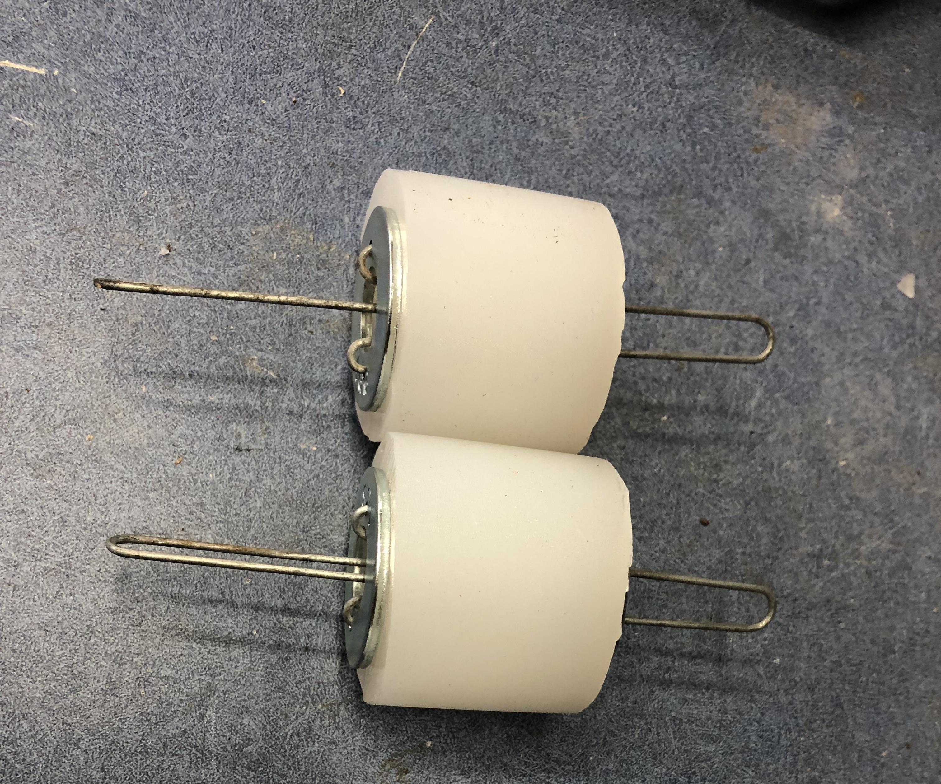

Now for the overhead racks. The uprights on the first cart are 1/2" EMT that telescopes inside the lower (3/4") legs. As a "stop", I simply drove a screw in the side of the upright. Plastic bushings on the tops of the legs made for a snug fit.
