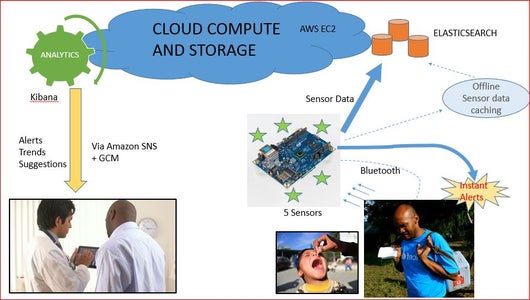

How does your Project technically work?
Intel Galileo board with multiple sensors (temperature, light, air quality, gyro) attached to it, is running in a portable box with vaccines, which a health worker is carrying. The board can be connected directly to WiFi, or we can enable to Bluetooth to connect to the mobile phone of the worker. Sensor data recorded is processed in an anomaly detection algorithm inside the IoT board and if it detects environment anomaly, the buzzer starts sounding. The processed data is also periodically pushed to the cloud for further analysis. Analyzed data will send a live Push Notification to the mobile phone of the health worker, and his coordinator (a meaningful and informative message is displayed) to handle the crisis situation effectively.
How does your Project take advantage of
a. Cloud connectivity?
Crucial sensor data recorded inside the portable box is periodically pushed to the cloud. Cloud has enough resource to efficiently process the huge amount of data received. The data analysis done on cloud, is not possible to do in the IoT board. The insights received from the data analysis not only helps a health worker take corrective measures on time, but also promises the building of a better solution in the future.
b. Sensor utilization?
Multiple sensors are used to monitor the environment of the portable box carrying the vaccines. In the future GPS sensors can also be added to track the movement of the health worker, generating more insights. The amount of information gathered from the sensors in an absolutely non-intrusive way is very effective in such ground level scenarios.

a. Connect the Galileo board directly to the phone using Bluetooth. In remote areas, where Internet connectivity is absent, the data from the sensors will be stored inside the phone's SD card over Bluetooth. Also, the data can be stored inside the IoT board itself. Later when the health worker is in Internet zone, the data will be pushed to the cloud.
b. An Android app for the health worker: Each health worker gets money for administering a vaccine. This is one of his biggest incentive. After administering the vaccine, he will be using the app to register the administration. These registrations will be used to calculate his incentive. As soon as the IoT board detects a vaccine going bad, it will disable the registration of administering of that vaccine. This way, the health worker won't administer a spoiled vaccine, just for incentive.
c. One box can be made to carry different kinds of vaccine vials to reduce luggage. Each type of vaccine has a different set of optimal environmental thresholds. The IoT kit should be able to monitor each of the different vaccine vials, based on their different set of optimal thresholds, and not using one common set of thresholds for all the vials in the box.
