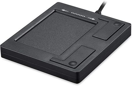

  3. Touchpad used - Perixx PERIPAD-501 - Amazon link
  4. This is definitely the cheapest one on amazon

Step 2: Measure and Cut Out the Trackpad's Installation Region
Use an X-acto knife (or any similarly suitable cutting instrument) to cut out the rectangular patch.
Step 3: Drill a Hole Through the Top Plate for the Touchpad's Flex Cable
Step 4: Pass the Touchpad's Flex Cable Through the Hole and Hot Glue the Touchpad in Place
Generously spread hot glue onto the base and hold the touchpad in place until the hot glue cools off.
Step 5: Drill a Hole for the Touchpad's USB Cable
Step 6: Reconnect the Touchpad's Flex Cable and Reassemble the Keyboard With Screws
After adding back all the screws, seal the edges of the trackpad for aesthetics
