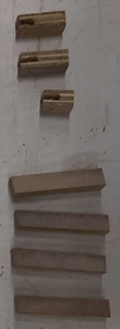

Step 1: Measurements
First of all, gather the suplies. Then draw the following measurements out:
Fuselage: 21cm long, 3,5cm wide and 3,5cm high (spruce wood)
Front wings: 21cm long, 6cm wide and 0,5cm high (2x) (plywood)
Back wing: 8cm long, 3,5 cm wide and 0,5cm high (plywood)
rudder: 3,5cm long, 0,5cm wide and 3,5cm high (plywood)
front chassis: 1cm long, 1cm wide and 2,7cm high (2x) (plywood)
back chassis: 1cm long, 1cm wide and 0,7cm high (plywood)
front buttons: diameter=2,5cm, 0,3cm wide (2x)
back button: diameter= 2cm, 0,3cm wide
nail: diameter= 0,3cm, length doesn't matter much. 2-3cm optimal
propeller: 1cm long, 1cm wide and 5cm high (plywood)
"pillars": 1cm long, 1cm wide and 5cm high (4x) (plywood) - (more explained in step 4)
