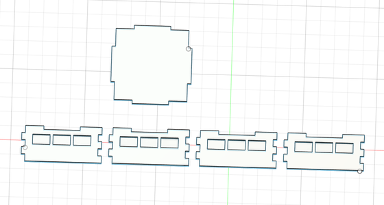

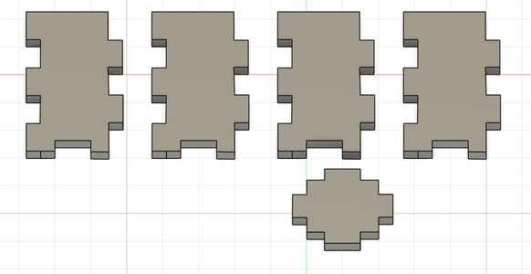

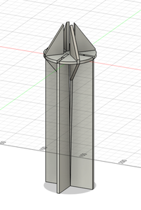

2 Base boards that contained a mountain design along the edge. They were both made in blender utilizing 3 modifiers: Subdivision, Vertex Weight Proximity, and Displace. A texture was added to the displace modifier; Clouds. An extrusion was required in order for it to properly print. The mini wooden buildings and the really large tower were made in Fusion. With press fit joints and a ceiling that would fit. Both were entirely parameterized. The white mini buildings were also 3d printed with white PLA. All were made without modifiers except for the tall rectangular one, which used a wireframe modifier.

Printed the mountains via prusaslicer software. The laser cut buildings we're all laser cut into pieces that were fit together.
