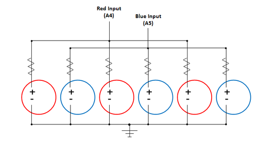

Step 3: Wiring the Lights
The lights need to be wired in parallel to shine brightly, but also to have resistors so as not to blow them out. The resistance will vary based on the type of LED you chose and the power source. We used 5mm superbright LEDs with 330 ohm resistors and a 9V battery as a power supply.
Put a resistor in series with each LED, then wire the three red LEDs in parallel with each other and the three blue LEDs in parallel with each other. Wire all the LEDs to a common ground, such as the ground of the battery. Make sure to wire the Arduino's ground to that ground as well.
This is the circuit diagram for our lights, Red Input and Blue Input imply a connection to one of the Arduino's digital ports. There will be a full circuit diagram for how to wire everything to the Arduino later on.

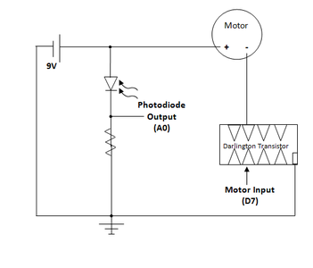

Step 5: Wiring the Motor
This is the most complicated wiring section, as it consists of two separate circuits. The first is the photo diode circuit which requires it's own power source and provides the signal to the car for whether it should turn on or off. The second is the motor circuit.
The best description of this wiring is shown in the diagram below, but a short explanation will also be useful. When the photo diode is not sensing light there is no current flowing through it and thus no current flowing through the resistor so the reading at A0 should be high (~9V). When light activates the photo diode it starts drawing current and there will be a voltage drop across the resistor, causing the reading at A0 to go low (~0V). This change in reading will be interpreted through the Arduino and sent as a signal to the motor input. The Darlington transistor helps amplify the current so the motor can run.
Toy motors aren't usually polarized but the darlington transistor definitely is. Make sure you have it connected the right way, so the collector is attached to D7 and the emitter is attached to the far side of the motor.

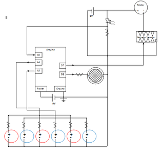

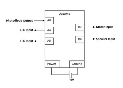

Step 6: Putting It All Together
Now we just need to wire all the different parts to the Arduino, and make sure to connect all the grounds together so they all have the same value. The diagrams below show the Arduino and which ports should be connecting to which circuits, and the full diagram with all the parts together. Make sure to use enough wire so that you can maneuver the parts around the inside of the car. When you have everything wired to the Arduino zip-tie all the wires attached to the Arduino together and to the hole in the Arduino board. Then they will be secure.
