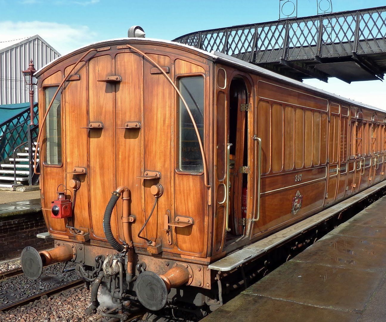

The story starts some 5 years ago, seeing the 100 year old teak London Underground coaches known as the Chesham set, built around 1898. The coaches have a lot of history, and are some of the oldest preserved coaches, but sadly no-one produces models or kits of these wonderful coaches, which is where I have to get creative.

I also visited the Bluebell Railway in Sussex to photograph various areas of the coaches, like the doors, the panelling / mouldings, wheel sets, buffers, and any small details.

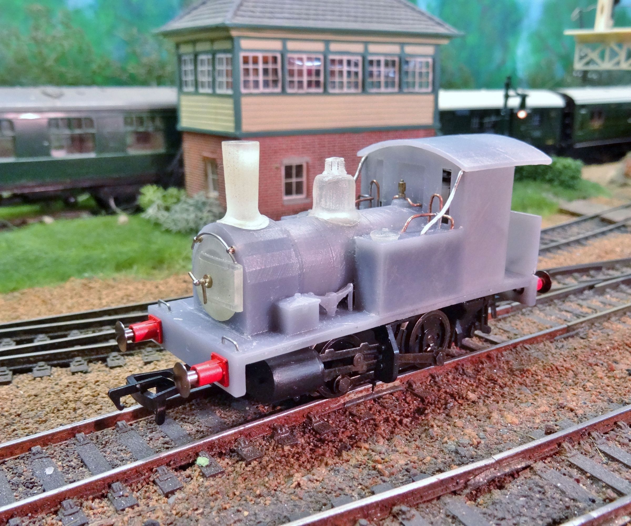

So the last coach body was to be printed so I started looking around for a printer in the UK to see if I could get them printed in the same/similar material. I found a 3D print place in my local town who actually do work for Formula 1 teams, and they use the SLA type printer.
The company Graphite additive manufacturing company took up one of my models to be printed in a Grey resin.
The finish of the fresh printed model was the next step up from a desktop printer and was simply amazing... then again it should be for the price....
