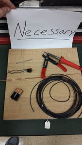

To build this Instructable you will need:
Soldering Iron
Wire Stripper
1/8" Stiff Metal Dowel
20ft of Wire, no larger than 1/8" in diameter
Switch
1/8" Drill Bit
Flat Piece of Wood, at Least 12"X12"
Rocket with engines and igniter plugs (Of Course)
Optional but Recommended:
Super Glue
Electrical Tape
2 Aligator Clips

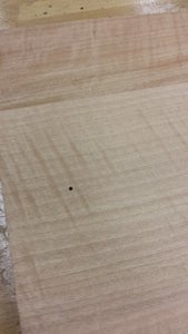

Using a drill, make a 1/8" hole near the edge of the piece of wood, about halfway Down, and an inch or two in.
Step 3: Step 3: Rod Placement
Put the rod into the hole. I secured it with Epoxy/Super Glue, however this isn't necessary.

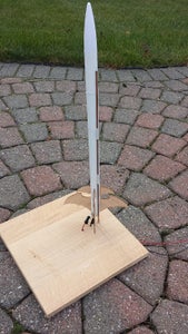

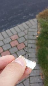

Step 10: Step 8: Hooking It Up to the Rocket
Take your model rocket and place it on the rod, using the straw-like part that will come with your rocket. Next, hook each wire to one of the prongs coming from the igniter plug that will come with the rocket engines. Orientation of the wires does not matter; As long as one wire goes to one prong, there will be enough energy from the 9v battery to short circuit the igniter and launch the rocket.
Step 11: Step 9: We Have Liftoff!
Just go a safe distance away and close the circuit using the switch by holding it down for about 5 seconds, or toggling it for the same amount of time. Above is a video of me using the system to launch a 2-stage model rocket that I threw together in about an hour. It startled my little sister, whose voice you will hear near the end of the video.
Step 12: Step 10: After Thoughts
The above pictures show what both the igniter plug and launch pad look like after 1 launch. The Rocket will singe the pad itself, but in my experience with over 10 launches with this pad, it has not caught on fire or been any real hazard.
