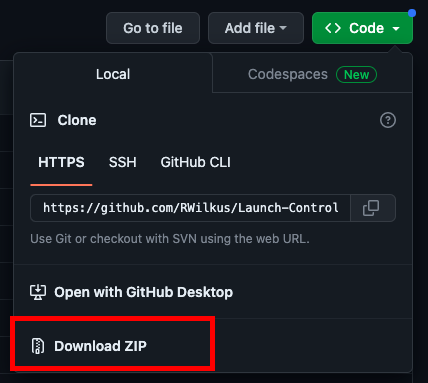

All documentation is stored on Github at https://github.com/RWilkus/Launch-Controller-1
Go to link and download zip file with all design files.

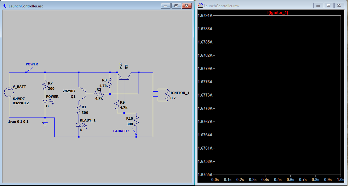

Simulation using LTSpice:
We found the Q1 base current was 1.2mA with a 4.7k resistor in series.
When the launch button is pressed, the voltage across the ignitor goes to near zero as the current increases to about 1.7A. This limitation is based on the series resistance of the batteries, printed circuit board, Q2, and the wire to the ignitor.

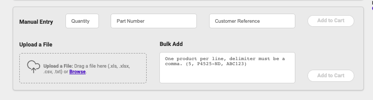

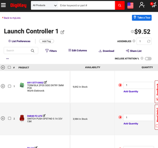

Step 1: Order Bill of Material
  1. Locate the BOM in the downloaded zip - Launch-Controller-1/LaunchController1 BOM.xlsx
  2. Go to https://www.digikey.com/ordering/shoppingcart?lang=en
  3. Click Upload a File
  4. Select the LaunchController1 BOM.xlsx file
  5. Verify parts are in stock and order!

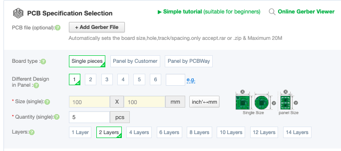

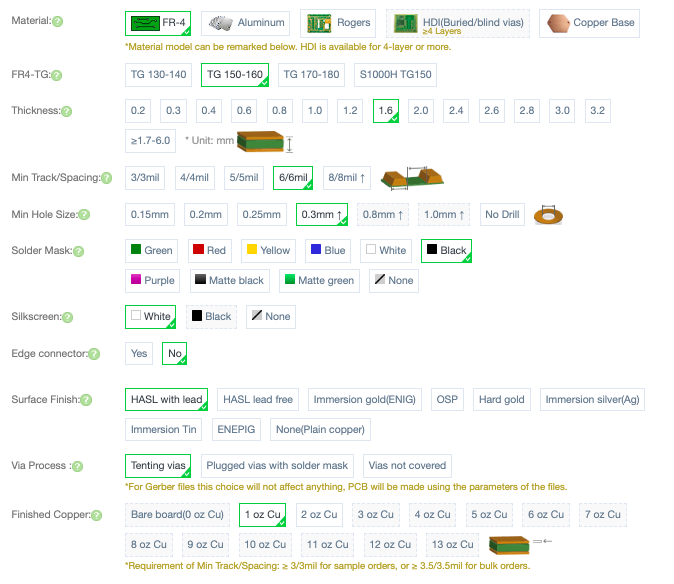

Step 2: Order Printed Circuit Board
PCBway.com has been a cheap option to get multiple boards. It cost me $15 for 10 boards!
  1. Go to https://www.pcbway.com/QuickOrderOnline.aspx
  2. Click "Add Gerber File" - Select LaunchController1 Rev * Gerbers.zip from your downloaded design files
  3. 2 layer, 1.6mm thickness, FR-4 TG 150-160 material, 1oz Cu, Black soldermask, White silkscreen, HASL with Lead surface finish (Refer to attached photo)
  4. Adjust board quantity to find maximum boards per price. 10 boards was the same price as 1 when I ordered.

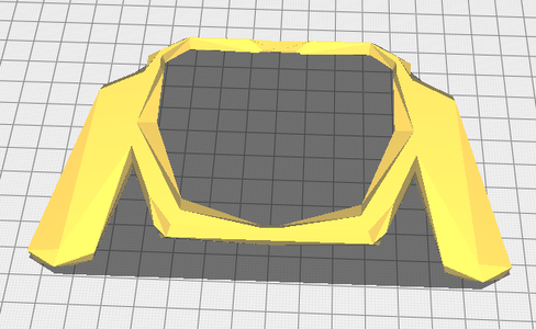

Step 4: 3D Printing
I have a JGMaker printer using Cura and 1.75mm PLA. Feel free to experiment with other settings per your printer.
Locate the print file: Launch-Controller-1/Enclosure/Launch Controller 1 Rev *.stl in your downloaded design files
Upload to your slicing software
Typical Settings:
  • Resolution: 0.2mm
  • Infill: 20%
  • Filament: 1.75mm
  • Supports: Yes
  • Rafts: Yes
Slice and print!
Remove supports and raft. There currently is a ledge that the bottom part of the PCB inserts into on the 3d print. You may need to use a knife to remove the support material from that area.
