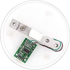

    Step 1: Strain Gauge
    The strain gauge recommended consists of a bar with some holes drilled in its side. On top and below the holes are some components glued on with epoxy. These components are strain gauge elements. When the bar is pressed at one end, the metal above the hole is stretched. The metal below the hole is squeezed. The elements measure this minute movement by means of a flexible, resistive PCB. As the PCB is stretched the resistance increases. Squeezing the PCB reduces the resistance. Between the Strain Gauge and the Arduino is a processing amplifier which takes the minute resistance changes and converts them into meaningful, readable values.
    The Strain Gauge amplifier has 6 connections at one end and only 4 at the other. We are going to use the 4 pin connector - Gnd, Vcc, Data and Clock to join the amplifier to the Arduino. The connection of these pins is shown in the overall wiring diagram. There are 4 wires coming from the Strain Gauge itself, Red, Black, White and Green. They are connected as follows : Red to E+, Black to E-, White to A- and Green to A+
    There is a small modification to do to the strain gauge amplifier board. Originally the sampling rate is 8 per second, which is not good enough for our purposes. If you look at the picture of the board you will see a large component calle U7. At the top right of U7 is a power supply pin (pin 16). The pin below it is the sample rate pin (pin 15). What is needed is to carefully apply heat from a soldering iron to pin 15 and lift it up from the PCB a tiny amount. The carefully bend the pin towards pin 16 so they overlap a little. The just quickly solder pin 15 to the top of pin 16.
    Don't worry, this sounds much harder than it is. Careful use of a soldering iron and some tweezers will get the job done in no time.
    The purpose of the modification is to change to sampling rate from 8 per second to 80 per second. Our system records 800 readings over the course of about 10 seconds, giving a good resolution. If the modification is not done, the results will be disappointingly blocky graphs.

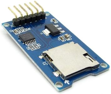

    Step 4: The Micro SD Module
    This module serves to record the data from the Strain Gauge. The interface to the Arduino is called SPI and it is a bit of a problem as we have a distinct lack of pins spare after installing the LCD Shield. However, I found a way around it in software so don't worry.
    The module takes data from the Arduino and writes it into a file that was created onto the Micro SD card. I designed the software to check the card quite early in the sequence to see if various criteria were met.
    Firstly the card had to be installed and properly formatted.
    The software then reads the directory and looks for files with the first characters "rdyno". The file system is such that there will then be a 2 digit number. The software looks for the highest number already used, then adds one. For example, if the last run produced a file with the name rdyno57, the software will generate a new file called rdyno58. As of now there is no real-time clock to date-stamp the files but you'll know that the highest file number is the most recent.
    In the next version I will remove the LCD Shield and add a real-time clock to properly record date/time and exact run time for each motor test.
