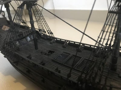

Step 8: Lightings (optional) and Finishing Off the Captains Quarters
The lamps in my case are some old miniature street lamp posts so I simply just modified them to fit the model. The 3 lamps are connected in parallel so in case one breaks the rest will not be affected. The lighting in the captain's quarter is from two filament lamps to give it that candlelight color. these are also connected parallelly. All are connected together and the outlet comes out near the stand of the ship which is then sent under the base of the display where there is a switch and a battery pack.
After we do the lighting we can add the top deck to finish off the decking. The windows here are made of oil paper and the grill is made of a metal wire diameter of 0.5 mm. The part of the captain's quarters jotting out is made entirely out of paper and card. The first step was to measure draw and cut everything to size in such a way the pieces fit perfectly. I would recommend if you could use some test pieces to determine the exact shape needed (I'm referring to the trial and error method).

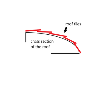

Then we paint the pieces before adding the oil paper. Then we paste the pieces and finish off the edges using a file to slightly smooth the card. then we add the roof in a tile textured way, that way is one on top of the other as shown in the drawing above.

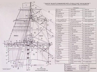

after adding your masts we can start rigging the ship. Rigging is the part where u add your ropes or in this case your nylon thread. this part is done realistically, the following video
https://www.youtube.com/watch?v=WUrRb66VSSE

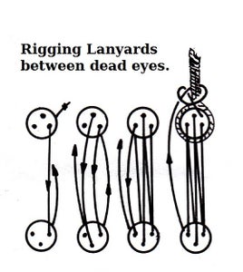

u can buy these small circles with holes(called deadeyes) from a hobby shop or like me make it out of a BBQ stick.
Simply cut out an appropriately sized out piece and use a file to sand out the outer rim to provide support for the rope to attach. and then use a small drill bit to drill out 3 holes. then we can use a needle to put the thread through the holes as shown in the above picture.
