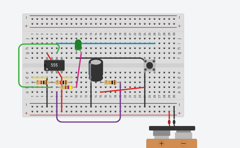

Step 4: Make the Analog Circuit
For the analog circuit, I used a 555 timer to turn on and off my RGB LED strip. My LED strip could only recieve 5V of current which is why I used a second Ardunio for power and ground rather then connected the circuit directly to a 9V battery.
Attached above is the circuit I made on the breadboard.
In the tinkercad circuit, you can see that I attached the LED to a 470 ohm resistor, however on my breadboard I did not. This is because, when a resistor was attached to the LED strip, it was not bright, regardless of the size of the resistor.
Above is the 555 timer schematic for easier visualization.
