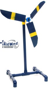

Introduction: Model Wind Turbine :: KidWind Project
This tutorial by KidWind teaches you how to make an electricity-producing model wind turbine with PVC pipe, balsa wood, a generator, and a few special parts.
Students, teachers, and hobbyists love using these turbines to learn and teach about wind energy science and technology.

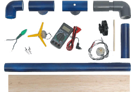

Step 2: Materials Needed
Hardware Store Parts
5X - 1" PVC 90 Degree Fittings
3X - 1" PVC T Fitting
1X - 1" PVC Coupler
6X - 6" Lengths of 1" PVC Pipe
1X - 24" Length of 1" PVC Pipe
1X - 2" Length of 1" PVC Pipe
2X - Alligator Clips
At least 3X - 15-18" Sheets of balsa wood (You can also use pie plates, index cards, or paper plates)
Special Parts (might want to check out KidWind website for these)
1X - Wind Turbine Generator (Small DC motor...many DC motors at hobby shops and hardware stores do not work well for generating measurable voltage at low RPMs)
4ft - 22 Gauge Hook Up Wire
1X - Crimping Hub (this is a special part sold by KidWind, but you can also use a tinker toy hub.)
At least 6X - 1/4' Diameter Poplar Dowels
Tools and Extra Materials Needed
Wire Strippers
Duct Tape
Glue
Drill
Other considerations
To test the power of your wind turbine, consider:
A Multimeter
Christmas LED Bulbs
You will need a fan or a wind source to make your wind turbine run. Head here for fan recommendations.

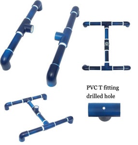

Step 3: Building the Tower & Base
First, drill a hole at the bottom of one PVC T. See image below.
1. Using (4) 90 Degree PVC fittings, (2) PVC Ts and (4) 6" PVC pipe sections, construct the two sides of the PVC turbine base. Make sure in this step to use the PVC Ts that do not have a hole drilled in them.
2. Fit the parts together without using glue (PVC glue is really nasty stuff). To make them fit snug, tap them together with a hammer or bang them on the floor once assembled.
3. Next, connect the two sides of the base using the PVC T with the hole. The hole will allow you to snake out the wires from the DC motor.

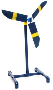

Step 5: Attaching the Tower to the Base
1. Snake the motor wires down the tower and through the hole in the PVC T at the base of the wind turbine.
2. It is sometimes helpful to place a piece of tape over the wires as they come out of the hole to prevent the wires from being broken at the motor if yanked too roughly.
3. Attach the nacelle to the top of the tower.
4. Insert the bottom of the PVC tower into the T at the center of the turbine base.
5. Assure that the PVC pipe is seated tightly into the fittings by tapping together with a hammer or by banging on the floor.
6. Do not use any glue so that you can take it apart and store it for next year!
7. Attach alligator clips to the wires coming out of the turbine to help hook up your turbine to a multimeter!

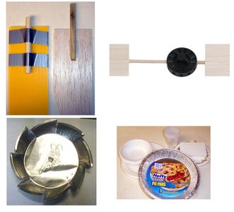

Step 6: Making Blades
Never make blades out of metal or any sharp edged material because they could cause injury during testing. Blades tend to spin very fast (300-600 RPM) and can easily cut people if they have sharp edges.
1. To make blades, carve or cut different shapes and sizes out of a variety of materials (wood, cardboard, felt, fabric). Tape or hot glue them to the dowels. Students have made blades out of styrofoam bowls, pie pans, and paper and plastic cups. Anything you find around the house or classroom can be made into blades!
2. Before testing check that the blades are securely attached to the dowel. If not secured properly, they may detach or deform as you test your turbine in high winds. We recommend using a combination of tape and hot or regular glue.
3. Insert the dowels into holes on the crimping hub. It is important to tighten the hub when inserting the blades so that they do not come out at high speed.
4. When attaching the blades to the hub consider a few important questions:
" How close is the root of your blade to the hub? What do you think is optimal?
" Are your blades about the same size and weight? Blades that are not balanced will cause vibrations that can reduce the efficiency of your turbine..
" Are the blades equally distributed around the hub? If not you can also have a set up that is out of balance.
" Have you secured the hub after you inserted the blades? If not they can fly out at high speed!
" Want to know how fast your blades are spinning? Get a Hangar 9 Micro Tachometer.
