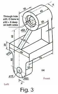

Step 2: ​Work Out How to Draw Our Object
The first step is to look at your model or object and decide the order in which you will model the different parts.
Try to think about how you will model the different parts so you can get an idea about which parts will rely on other parts, as you will need to model these parts first.
I decided to model the rectangular prism in the middle of the object first, then model the top part out from it and finally to model the bottom part.

Step 5: ​Modeling the Middle Rectangular Prism
First, draw the cross section of the center rectangle. It needs to be rectangle 60x70 units. To do this:
  • type REC
  • select rectangle by clicking on it in the menu, or just press enter
  • type 0,0,0 to set the start point to the origin
  • press enter
  • press D to set the dimensions
  • press enter
  • choose the length of the rectangle – type 70
  • enter
  • choose the width of the rectangle – type 60
  • enter
  • click so the rectangle is formed in the SE corner – see picture

  3. Create the big cylinder at the top of the part:
    • Copy an edge to use as guide – see pic
      • change UCS (universal coordinate system) to Left. This will allow us to easily draw objects orientated to this plane. To do this:
        • select the view tab at the top of the screen
        • inside the coordinates panel, click on the drop down menu where it says world and change it to left
      • copy edge with the copy edges tool just like you did before. Copy it in 30 units.
    • Draw the cylinder. We will draw two cylinders and join them, as this is the easiest way of doing it. One cylinder will go towards the left, and the other one will go towards the right, they will both start at the same place where the guide meets the top side of the rectangular prism. When we have drawn them both we will join them with the union tool.
      • Draw the left cylinder:
        • type CYL
        • press enter to select the cylinder tool
        • choose the center of the cylinders first face. Click where the new guide line and the top line meet. You will see a green square.
        • move mouse along X axis and click at the end of the rectangular prism to set the radius. You should see a blue square.

Step 7: Modeling the Bottom Part of the Object
  • On the view cube, select the corner between left, front and bottom and change the UCS to bottom
  • Change the visual style to hidden. You don't have to do this but I find it makes it easier to work as you don't get muddled by all the lines in the top part of the object.
  • Extrude the main bottom rectangular prism. The next part is hard to explain so please use the screen shots to help you work out what I am trying to say.
    • copy the line in 20 units – see picture
    • copy both adjacent lines in 10 units – see picture
    • press esc to exit copy edges tool
    • trim off excess lines to create a rectangle 40x20 units – see picture

      • select the original circle
      • press delete
    • set the UCS to world
    • click the corner of the view cube between left, back and bottom
    • set the UCS back to left
    • repeat the proces to create the upper fillet on the back side
Step 8: The Upper Triangle
You might have noticed that I have not talked about making the triangular prism bellow the upper triangle. I decided to leave it for you to work out. If you need some hints try using some of the tools we have learnt about including copy edges, and presspull tools. I also used the line tool (type LINE). Also make sure to change the UCS to the face you are working on.
Step 9: ​Exporting
3D printers use STL (STereoLithography) files. Read more on Wikipedia. To export a STL for 3D printing:
  • Go to the output tab
  • click send to 3D print service
  • drag around the whole object
  • press enter to export the selection
  • set the scale (usually just leave all the defaults and press OK)
  • choose where to save the STL file
  • now you can send the STL file to a 3D printing company or import it into the software that you use with you 3D printer
You can also import you STL into blender to animate it.
  • all parts that you want to animate separately must be separate
  • just export STL files in the same way as above and you can import them into blender by going file -> import -> STL
Step 10: Conclusion
Thanks for reading my instructable and I hope you got something out of it. If you still have questions please leave a comment and I will try to answer them as soon as I can.
