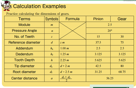

Step 1: The Tip Diameter (Using the Addendum)
For the equations above feel free to choose any value for number of teeth, pressure angle, and module. The values chosen for pressure angle and module in this tutorial are fairly common, and for a gear to mesh properly with another it must have the same pressure angle and module

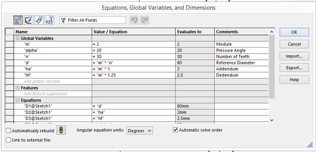

Begin making three concentric circles and setting the center circle as a center line, or as reference geometry. Set the new reference circle as the reference diameter. The larger circle should have a distance between itself and the reference circle equal to the addendum, and the smaller circle should have a distance between itself and the reference circle equal to the dedendum. Exit the sketch and extrude the circles 10mm midplane.
