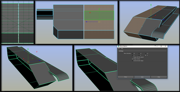

Step 1: Step 1. the Hull
Before starting, remember that every separate part is made by combining primitive solids. Each primitive must be combined into a single object. This way, you make sure that the model will print as one.

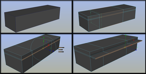

The modeling of the tank’s hull starts with a box. Draw edges, where the splashboard of the tank will be and use Extrude option to create the tank’s splashboard.
With the Bend option, create the front curve of the splashboard.
To create the front and the back of the tank, use the X, Y, Z axes to select the face which you want to remove from the cube. Once removed, the box will have a hollow space which must be filled. Select the two edges and create a bridge between them. Once the bridge is created (the part of brown-grey color), there still remain some hollow spaces (the spots in black, left and right) that must be filled. Select them and use the Fill Hole option. Do the same with the bottom front of the tank and the back. Play with the shape, until you achieve the one you want.
Use Bevel option for the lower line of the tank to make the edge “rounder” then prepare the object to be cut along its length and make the other half of it. For this, find the midline of the object, select the Faces you don’t need and use the Mirror Geometry Options. Thus, you create the entire hull of the tank. Cut the hull in half, to facilitate its 3D printing.

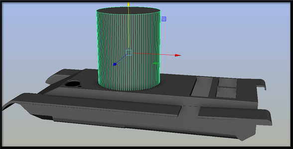

For the place where the turret will stand, create a primitive with the shape of the hollow for the turret, place it over the place where you want to make a hollow and use the Booleans-Difference option. Then, create the interior of the hull. Position a primitive box in the tank’s front interior.
The same applies for the rectangular hollows, where the engines are situated at the rear of the tank.

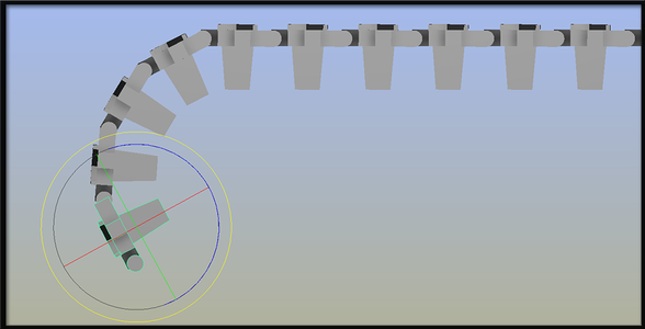

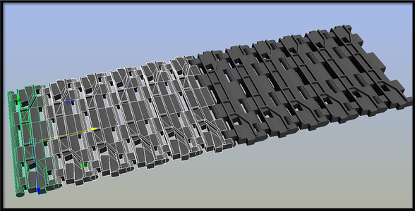

Step 4: Step 4. the Caterpillar Track
The caterpillar track consists of different primitives, which are modeled to create the element of the caterpillar. To build a caterpillar track, use the Duplicate function.
For the naturally-looking curve, rotate de duplicated parts, one by one, little by little.

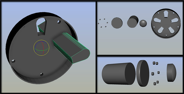

Step 5: Step 5. the Caterpillar Wheel
Another element of the caterpillar tracks is the wheel. Again, the wheel, just like any other tank part, is created from primitives.

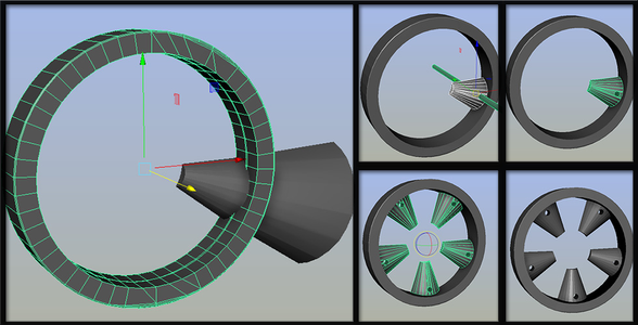

To make the wheel, use a polygon pipe and a cone. Use Booleans option to incorporate the cone in the polygon pipe and bring the cone tip closer to the center of the cylinder pipe. Duplicate the element around the wheel’s interior. Use a cylinder and the Booleans option to create an additional hollow in the cone, for aesthetic reasons.
Create the other half of the wheel from a modified primitive, resembling a flower petal. With the Booleans function and the modified primitive make hollows around the wheel. Additional hollows can be created similarly for aesthetic reasons, using a cylinder.
Other elements, like cylinders of different sizes, are used to enhance the wheel, adding more details and reality.

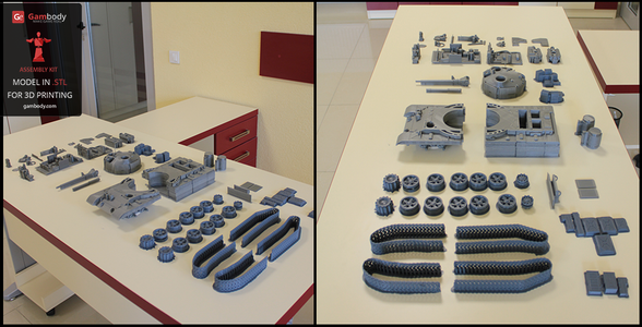

Considering the tank, with all its outer and interior layout elements, consists of 62 pieces, their 3D printing requires time. Every part is printed separately or with other small parts on the 3D printer’s heat bed, as long as they all fit on its surface.

The second video is the assembly guidelines for the same 3D model, with every part being numbered.
