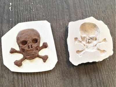

When I am making a relief I like to draw or print a suitable image to size. Then I sketch it a couple of times as I find this fixes it in my brain.
Draw the outline of the image on your surface with pencil. Trace or cut out your picture and draw around it if you like. This fixes the scale.
Fill your drawing with small pieces of clay, pressing them down firmly.
Build up the relief. Repeatedly measure and check against your original print or drawing.
To get a piece I am reasonably happy with I find I build up, remove, build up, remove and keep working away.

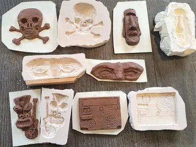

Step 2: When They Made Him They Threw Away the Mould
Don't throw away the mould...
I find a container a bit larger than my mould just in case my foil bursts and I leak plaster everywhere.
Cut 2 layers of kitchen foil large enough to envelop your piece. Wrap around carefully and press crimp the corners, being careful not to tear it. You really want to make it at least an inch higher than the top of your piece.
Mix up your plaster according to the instructions, always adding the powder to the water. I wrote the mix on the bucket I use so that I don't have to look it up every time.
I find it helpful to repeatedly tap the mix onto a work surface to try and bring all the air bubbles to the surface.
Tip the mix into the mould. I try to do this from a bit of a height, maybe a foot or two, as the pressure of the drop helps fill any voids.
Once dry, remove your original and admire your handiwork.
Repeat.
In this case, these are all images from a band I like; the Witchdoktors, as their images fit well with the Tiki theme I had in mind.

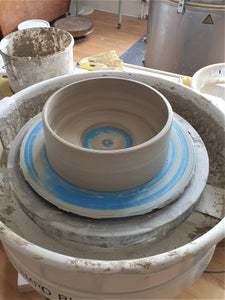

If you use a potters wheel you will probably know how to do this, so I'll keep it short:

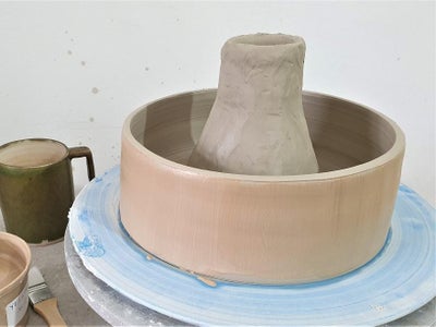

Throw a straight sided bowl with a large hole in the middle.
Throw an open volcano shape just larger than the hole in the bowl.
Throw a small bowl for the crater to fit the top of the volcano.
Trim, score, slip and join the pieces.
I also painted the outside of mine with yellow slip for that Tiki bamboo vibe.
I also threw 4 matching beakers.

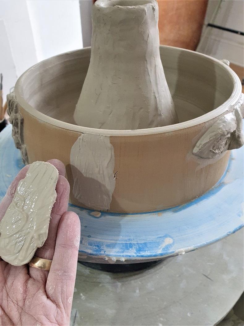

Step 4: Sprig Is in the Air

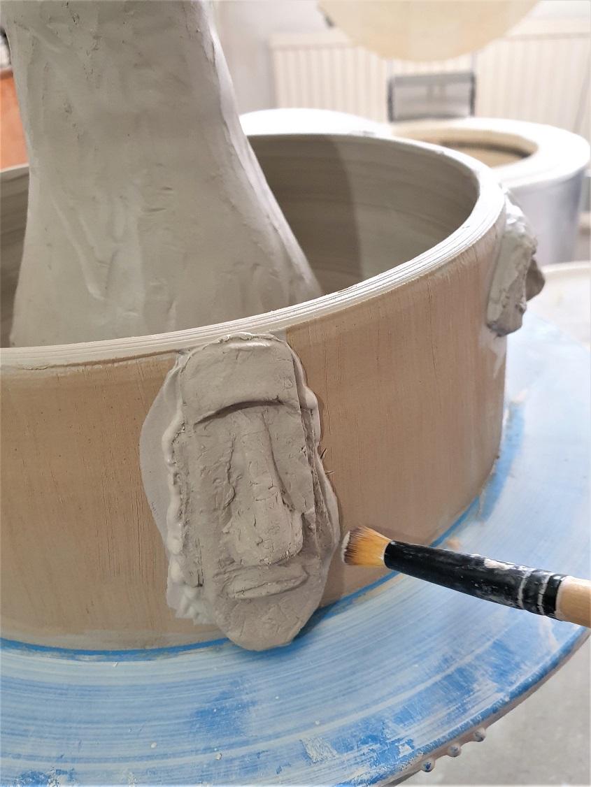

Once the bowl and mugs are sufficiently dry it is time to apply the 'sprigs'.

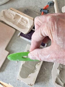

Firmly push clay into the moulds, pushing hard to get any air bubbles out.
Scrape across the top with some firm plastic getting a nice level surface. If you use metal small pieces of plaster will end up in the clay and these will be disastrous for the firing.
Allow a few minutes for the plaster to suck some moisture out then it's time to release the sprig. Push the flat surface of the knife against the clay to get a kind of suction and with small moves keep trying to pop the hole thing out. It is a bit trick at first, but it will come with practice. You have the mould so it doesn't matter if you mess a few up.
Score and slip the bowl and the sprig and carefully put them together, being sure not to trap any air.
