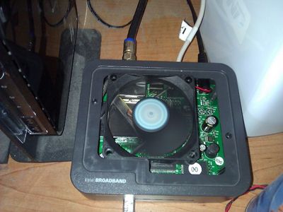

Basically I have been having problems with my modem overheating constantly to the point of the internet being unusable. To fix this problem I decided to install a fan to cool it off.

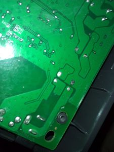

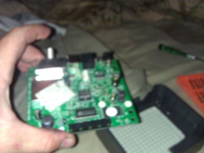

Step 1: Disassembly
Yours will vary depending on the manufacturer of the modem. As you can see I first had to remove the rubber feet covering the screw heads. Unscrew then pry the case apart.
Then pop the circuit board out of the top housing.
To make the fan fit I removed the top cover(gray piece in the third picture) it was just held in with snaptabs.

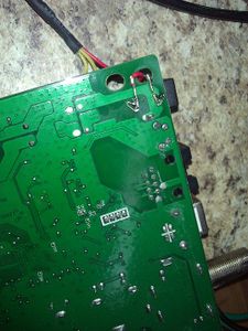

Step 2: Soldering
To do this I used a pick tool to disassemble the connector on the cpu fan to expose the clips you see in the picture. I found the tabs using a multimeter. This is my first time I have ever soldered so its pretty sloppy I have only ever done plumbing pipe before.

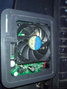

Step 3: Reassemble
Luckly the fan I chose fit perfectly into the case without need for any kind anchors.
I plugged it in and it has been running great ever since.

The final pic is of it running.
