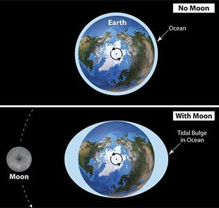

The easiest graphic to explain tides portrays the earth with water bulges on it sides. The earth rotates daily through these two bulges dragging its coastal occupants through two periodic highs and lows. I designed this tide clock to simulate in graphical form the movement through these watery distortions. The tide clock is totally 3D printed, battery operated and can be made for less than $15 so a great project for kids. The design is modern and you can quickly ascertain the local tide level with a quick glance from across the room. The clock gets it time and tide levels from the internet; looking up the tide heights from the NOAA API. The wifi credentials as well as the nearest local tide station are input through your phone and the whole thing can be set up and working in a minute. Charging is done with a USB-C connection and the large built in lipo battery should last for weeks as the enclosed ESP32S3 unit sleeps and wakes up to adjust wheel only every 30 minutes.

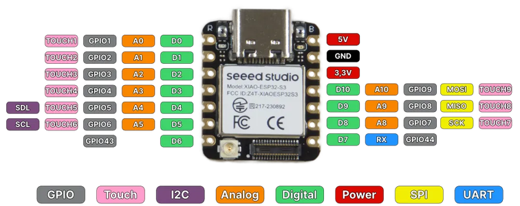

You need a 3D printer. The microcontroller for this project is a Xaio ESP32S3 which works great because of its small size and great software help. I used the above Servo for several projects and found it works fine with the lower voltage of the lipo battery.

Step 1: Wire It
The wiring is straightforward; basically a few GPIO pins off of the main xaioESP32S3 to control the servo and the servo power. The Lipo battery POS is connected to the ON/OFF switch. The other side of the switch is connected to the POS on the back of the MCU as well as the Source on the P-MOSFET. (Term 3) The battery ground is connected directly to the rear battery NEG terminal on the MCU. P-MOSFET Gate (Terminal 1) is connected to GPIO D7 and Drain (Terminal 2) is connected to servo power (Red Wire). One side of the push button is connected to GPIO D9 and the other side to ground from the MCU. The ground from the Servo is also connected to GND either on the board or shared with the pushbutton. The yellow control wire from the Servo is connected to GPIO D8. The way the wiring control works is GPIO D7 is held high by the software until power is needed by the servo when D7 is brought low providing power through the MOSFET to the servo. When servo action is completed servo is disconnected and power is turned off by raising D7. Charging of the battery is through the MCU and the ON/OF switch must be on for this to occur.
