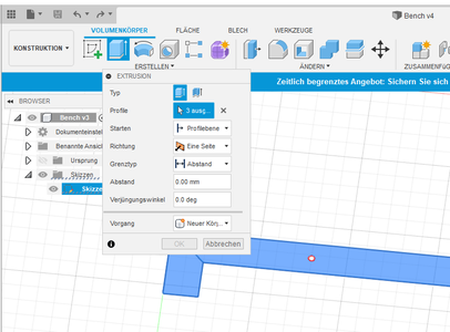

I did a few rough drawings on paper and used fusion 360 to get an Idea of the finished bench.
Actually I haven't used fusion 360 in the past to plan furniture, but it is never too late to learn something new.
There are many great turtorials out there, so I guess it is not necessary to do the same here.

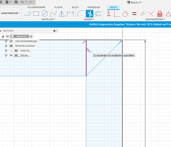

I would like to point out one functionality I do really enjoy the most since it works perfectly fine, the "cutting"-tool. I used it to add the 45 degree angle to the beams. First I drawed overlapping rectangles, added a line to connect both corners and used the cutting tool to delete the unnecessary lines.
Since it was my first attempt to make a 3d part in fusion 360, I guess it came out very nice and it was only around one hour of work including building up know how. The real sketching time was only around 15 minutes, so it is definitively comprable to a colored drawing.
For me it turned out that I will use fusion 360 more often in the future regarding 3d projects, also the rendering function is great:-)
