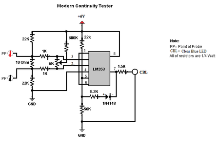

Step 1: Diagram 1
In the diagram 1, you are going to observe all connections that you have do in the project, and therefore, the entire project is available for you. However, you must follow carefully step by step this diagram so that you can complete the project successfully.
Step 2: Diagram 2
In the diagram 2, you are going to observe all connections that you have do in the project, and therefore, the entire project is available for you. However, you must follow carefully step by step this diagram so that you can complete the project successfully. Once finished the project, you will be capable of adjust it joining its test leads and using a screwdriver for manipulating the trimmer: it will provoke the lit of your Blue LED. Finally, unjoint the test leads of your project and adjust it until it´s turned off its Blue LED while turned on with its test leads joined.

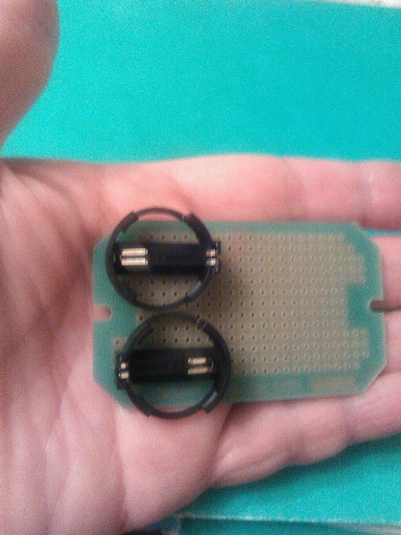

Step 4: Battery Holder 1
Install the battery holders and solder them on the PCB by noting the polarity of each holder: above holder shows from left to right its polarities positive(+) and negative(-) respectively while bottom holder shows its polarities in opposite form.
Step 5: Battery Holder 2
In the back side of the PCB, connect the polarity negative(-) with the polarity positive(+) of both battery holders by using a wire to join their pins showed in the left side of your PCB.

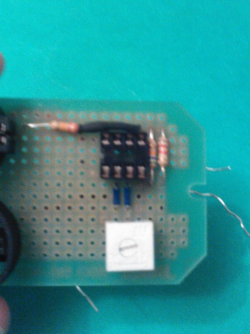

Step 6: IC Socket & Potentiometer 1
Now, install the IC Socket of 8-Pin and the trimmer of 5K while you note both the polarity positive(+) and the polarity negative(-) of the battery holders in the above side and bottom side of your PCB respectively. That is, the battery holders form an only power supply.
Step 7: IC Socket & Potentiometer 2
In this step, connect the extreme pins of your trimmer while leaving free the middle pin of the same trimmer. For connecting the previous pins, connect left pin to pin 2 and right pin to pin 3 of the LM358.

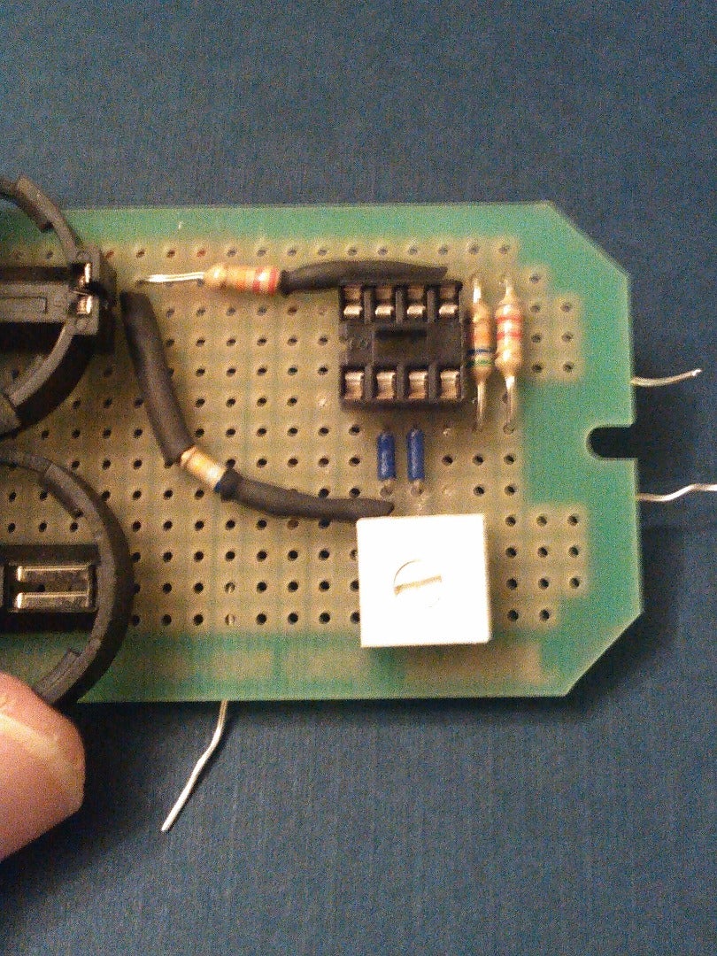

Step 8: Resistors of 1K Ohm 1
In this step, connect the resistors of 1K to left pin and right pin of your trimmer respectively while leaving free the others leads of the resistors.
Step 9: Battery Holder 3
In this step, you are going to connect LM358 in its pins 4 to GND and 8 to +6V while interconnecting its pins 1 and 6.
Step 10: Resistors to IC Socket, Pin 5
In this step, you are going to connect to LM358 in its pin 5 the resistors of 22K, 56K, and 8.2K while leaving free the other terminal of this last resistor and will only connect the others remaining leads to +6V and GND respectively.
Step 11: Resistors of 680 K Ohm
In this step, you are going to install the resistor of 680K to the middle terminal of your trimmer of 5K while the other lead will be connected to +6V.
Step 12: Installing Resistors to +6V
Connect the resistor of 22K to +6V while the other terminal to the resistor of 1K that have its other lead connected to pin 3 of LM358.
Step 13: Resistors of 1K Ohm 2
From the remaining terminal of the resistor of 1K which was connected its other lead to pin 3 of the LM358, you should draw a red wire.
Step 14: Resistors of 1K Ohm 3
From the remaining terminal of the resistor of 1K which was connected its other lead to pin 2 of the LM358, you should draw a black wire.
Step 15: Installing Resistor to GND
Connect the remaining lead of the resistor of 22K drew of the resistor of 1K and also connected the black wire previously drew in the step 14 to GND.
Step 16: Connecting the Diode
In this step, you are going to connect the diode to pin 7 of your LM358 and to the remaining terminal of the resistor of 8.2K its negative (-) and positive (+) terminal respectively. Also you will connect to resistor of 1.5K between pin 7 of the LM358 and anode of your blue LED..

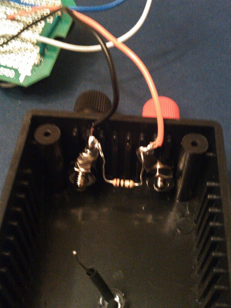

Step 23: Installing the Resistor of 10 Ohm 1
Connect the resistor of 10 Ohm between the connectors of your Binding Post Breadboard Screw Type Chassis Mount 1 Black 1 Red.
Step 24: Installing the Resistor of 10 Ohm 2
Now, install the its place the resistor of 10 Ohm.
