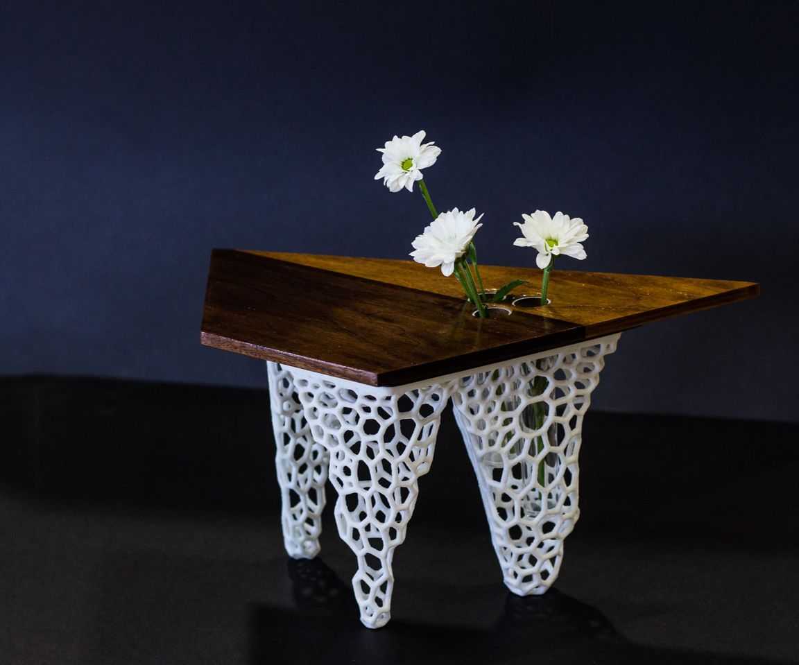

Was going through some older media and thought that you folks might enjoy this vase I made almost a year ago. At the time I was working in a local makerspace and had all the tools my lazy time lacking self could want. As this was something I wanted to make as well as useful since my girlfriend actually needed a vase and her birthday was closing in - the game was on!
Keep in mind that this is perfectly doable without having fancy tools like a CNC router, thickness planer and even slab of ash and I'll offer you solutions how in the further steps.

Step 4: Drilling Holes for Legs and Test Tubes
This is a little trickier than the cutting part, you should think and measure before you drill (as is usually the case I guess).
To avoid eyeballing the distances and arrangements I made a drilling template Illuminati would be proud of. You can find it attached to this step in both vector PDF and Fusion360 formats - you can change the Fusion one to specifications you need, it's a fully defined sketch.
You want the holes for legs to be slightly diagonal (10 degrees in my case) for stability and the holes for test tubes should remain straight. I would also suggest using some kind of marking on the drill bit for leg holes (masking tape works well) to avoid drilling through the wood. I didn't do that since the drill wasn't capable of going far enough to drill through.
As for the test tube holes - I made small pilot holes drilling through the template, then flipped the wood piece around and drilled from the would be top to the bottom. This was done to avoid potential tearout at the top (visible side).

Step 6: Fitting the Test Tubes In
The first picture shows an initial test on a piece of plywood which got me all happy and optimistic. The reality was a little different. To fit in 3 test tubes successfully I had to destroy another 3 in the process.
Some things to keep in mind. First of all - wear thick leather gloves when inserting the test tubes. Expect it to break at any time and think where would your hand go if there would be no more resistance working against you. You don't want to stain the wood with blood.
Test tubes have a fire polished lip which might be of a larger diameter than the rest of the tube (unless you buy lip-less tubes which I don't recommend). This means that you might have to insert the tube from the top down. In my case it turned out that the tube wasn't of a consistent diameter all over, somehow I managed to slide them in from the bottom up and they held in place. Still don't understand how.
If it seems like the tube doesn't fit - don't try to force it as you will have to refer to the first thing I asked to keep in mind. The tube should go in with minimal friction or even none at all as long as it doesn't wobble around and the lip is big enough to keep in from falling through.
Some people mentioned to me that buying more expensive test tubes from established manufacturers is likely to make this easier as they are of a very consistent diameter. There are also options with a thicker wall if I recall correctly.
With all this in mind you will need to adjust the drilled holes just right for the test tubes. I used a rotary tool with a small sanding drum attachment (around 8mm in diameter) to sand the holes just big enough. Standard Dremel sanding drum is bigger and right around 16mm and it might work for this, but it will get stuck in the hole and may burn the motor of your tool in the process.
