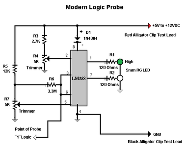

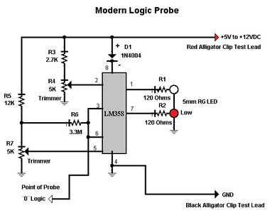

Modern Logic Probe was designed to measure 0´s and 1´s logics and for working with a voltage from 5V to 12VDC. This project was based in an LM358 and a common cathode RG LED to its monitorial. The Modern Logic Probe is capable of being adjusted to 0V with help of a couple of trimmers of 5K for turning off the RG LED. Using the project, the result is a RED led turns on when a ´zero logic´ is applied or a Green LED turns on when an ´one logic´ is applied.

In this diagram 1, you can see a LED lit and its light is red because a ´zero´ logic is being applied in the point of probe (connected to pins: 3 & 6) of your project. Also note that the LED is a type of common ground connection, so you can simply connect to their respective resistors so that you can monitor the result either ´zero´ or ´one´. According to the project, you will connect pin 4 & diode´s positive terminal to GND & positive terminal of this project (alligator clips black & red) respectively while diode´s negative terminal to pin 8 from LM358.

In this diagram 2, you can see a LED lit and its light is green because an ´one´ logic is being applied in the point of probe (connected to pins: 3 & 6) of your project. Also note that the LED is a type of common ground connection, so you can simply connect to their respective resistors (checking colors green and red to pins 1 & 7 respectively) so that you can monitor the result either ´zero´ or ´one´. According to the project, you will connect pin 4 & diode´s positive terminal to GND & positive terminal of this project (alligator clips black & red) respectively while diode´s negative terminal to pin 8 from LM358. You will besides connect to pins: 3 & 6 a resistor of 3.3 M Ohms while its terminal remaining to a resistor of 12K and trimmer of 5K. Then you should connect the terminal remaining of 12K resistor to diode´s positive terminal and 2.7K resistor while the terminal remaining of 2.7K to the other trimmer of 5K. Now, observe that the middle terminal of each trimmer of 5K should be connected to the pins: 1 & 5 where the first has connected a resistor of 2.7K while the second has both a resistor of 12K and other of 3.3MOhms, and without forgetting that you should connect both terminal remaining of the two trimmer of 5K to GND.

Step 15: Installing Components 1
Taking the PCB, install the two trimmers of 5K and the IC socket of 8 pins.
Step 16: Installing Components 2
In this step, install the resistors of 12K, 2.7K, 3.3M Ohms and the diode 1N4004.
Step 17: Installing Components 3
For doing connections to the trimmers of 5K, I´m using green, brown and white wire. Note that you should check the project´s diagram constantly to avoid errors.

Step 23: Adjusting the Project
In this step, you should adjust the project by manipulating the trimmers of 5K. That is, only adjust a trimmer by using a screwdriver until the LED is lit and no more so that you can obtain a red LED lit when a ´zero´ logic is applied. Then just adjust the other trimmer by using a screwdriver until the LED is lit and no more so that you can obtain a green LED lit when an ´one´ logic is applied. Once adjusted, until your project works correctly, you can close the box by using the srews included in this enclosure.

For checking if the project functions correctly, you have to use it. The suggestion is that this kit be utilized for checking a ´0´ logic and observe the color of light lit: in this case, it should be red color. Now, a fast way would be to take any circuit that you already have done and if it works with a voltage from 5V to 12VDC then you can check your project by connecting the black & red alligator clips to GND & Vcc respectively where you will check a ´zero´ logic on GND of your own project.

For checking if the project functions correctly, you have to use it. The suggestion is that this kit be utilized for checking a ´1´ logic and observe the color of light lit: in this case, it should be green color. Now, a fast way would be to take any circuit that you already have done and if it works with a voltage from 5V to 12VDC then you can check your project by connecting the black & red alligator clips to GND & Vcc respectively where you will check an ´one´ logic on Vcc of your own project.
