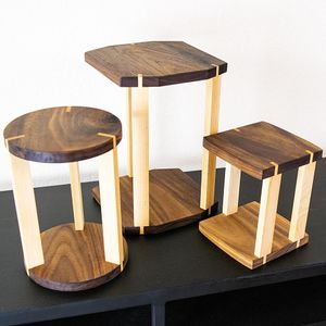

I made a set of modern plant stands with exposed tenons. My wife has amassed a bunch of house plants and we needed more ways to display them all! The stands can be used as speaker stands or any display pedestal. The exposed mortise and tenon joinery is relatively simple, making this a good project for any woodworker.
For this project, I used walnut and maple hardwood to add a ton of contrast and showcase the joint. But you can use whatever wood species you like for this project - I would just recommend that you use hardwood. I enjoy building projects that serve two purposes, one being design aesthetic and the other utilitarian. This woodworking project hits on both of those notes, and I couldn't be happier with the final result.
I am a huge fan of minimal design that packs a big punch. So I took that to heart when designing these pieces. I tried just to let the joinery tell the story. You can have fun with this one and create a ton of shapes for your home. I had a ton of fun with this one, and I hope you enjoy the project as much as I did. Plans for this project are available to download below. Enjoy the build!

Put some plants on top of these stands and admire their beauty!
