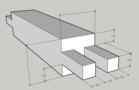

Step 1: Basic Design for the Frame
The frame design is relatively simple and consists of wood beams of two different lengths, each with two prongs located at the ends. The prongs are dimensioned to fit snugly when placed in position.
The rectangular frame I designed calls for a 5” x 5” base and measures 20” tall, but these dimensions can be altered to what is needed / how much wood you have available. I chose a hard wood like oak since I was aiming to make the beams ¾” x ¾” but if a softwood is used, I would recommend making the beams bigger, at least 1” x 1”. The length and thickness of the prongs on the beams follows the following guidelines (note these are only for beams with their length and width are the same):
Prong depth = beam thickness
Prong length and width = beam thickness divided by three
Gap between prongs depth = beam thickness
Gap between prongs length and width = beam thickness divided by three
Length of the cut area above and below the prongs = beam thickness divided by three
For the material used the thickness (X) is ¾”.
When cutting the stock into square beams try to make it as close to the stock thickness as possible. Depending on the quality of the wood used additional prep in the form of jointing or planing may be required.

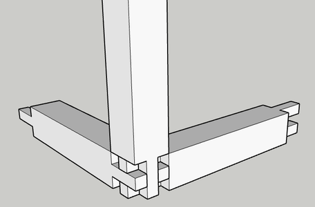

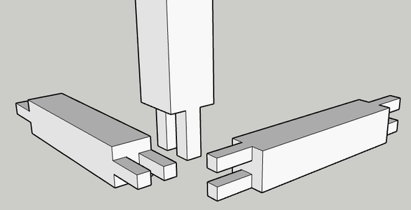

When making the prongs for each beam end this can be done in two ways. It can either be done with a router with a rabbet bit or a table saw with a flat top saw blade. If using the router option, the bit should allow for a cut depth of ¾” and have a maximum cutting height of ¼”. The table saw can be used to cut the slots out, but the sizes of the pieces may be a bit too risky for some woodworkers. Be sure to take the necessary safety precautions when using either the router or table saw.
Using the router
Routers cut by spinning the router bit and taking small slices out of the wood. When using the method, I made sure to only take light passes in order to avoid as much chipping and fraying of the wood as possible. This may take a bit longer than the table saw method but allows for a smoother finish if performed correctly. I started by routing out the top and bottom 1/4" to make the center prong. After that I sliced into the center very carefully with small passes making sure to avoid any chipping or splitting of the wood in the center. I chose to make the prongs slightly oversized and then sanded them down to their final thickness.
Using the table saw
The table saw can be used to make the shallow cuts needed for the prongs, but extra care needs to be considered. The use of push blocks and cutting sleds will make the cutting much safer than trying to freehand it with just the table saw fence. Make sure to avoid dangerous practices like pinching the cutting material between the fence and saw blade. With the table saw I focused on cutting out the 1/4" chunks on the top and bottom to make the 1/4" prongs. This was done by raising the saw blade height to 1/4" and taking light passes from the end to 3/4" in from the end of the beam. After those are cut I raised the table saw blade to 3/4" and slowly cut out the center gap, making sure to leave just a bit more than 1/4" worth of material on both side. I chose to make the prongs slightly oversized and then sanded them down to their final thickness.
After the prongs have been cut on all the beams, do a dry fit to make sure everything fits together. Sandi anything down that isn't fitting together properly, making sure the fit is snug but not too tight.

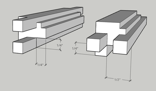

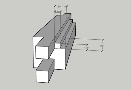

Once the prongs are cut out, window slots are added to each of the twelve beams. These slots will be used to mount acrylic, paper, or other light shading material. These, like the end prongs, can be cut with either a router or a table saw. The slots are located on one corner of a beam with two 1/8” wide slots cut ¼” deep. To avoid any mistakes when cutting, dry fit the frame and mark the interior edge of each beam as that is where the slots will be.
Once all the beam slots are cut, soften the edges with a light 220 grit sanding. The purpose of this is to remove any sharp edges that are still present of the beams so don't go too hard with the sanding.

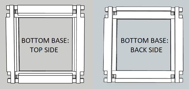

The four beams being used as the base of the frame get an additional groove cut into them to hold the plywood which the light socket fixture is mounted on. The two beams with the prongs horizontally aligned have a 1/4" slot cut 1/2" into the beam's bottom side while the two with the prongs aligned vertically get a 1/4" slot cut 1/4" deep into the beam's bottom side.
Step 4: Mounting the Light Socket and Making the Base
Fit together the bottom four beams oriented so the additional bottom slots are facing each other. Measure the length between each of the slots which should be around 4” x 4½”. Cut out an appropriately sized rectangular piece of plywood and notched out four ¼” x ¼” squares on each corner so the plywood can fit into the slot. Drill out a 1/2" hole in the center which will be used to thread the lamp socket wire through. Attach the plywood base onto the bottom of the square beam frame using a drill and ½” wood screws. drill two holes, each on one of the beams with the 1/2" wide slot cut out. Try to use thin screws and manually attach the screws to avoid any splitting of the wood.

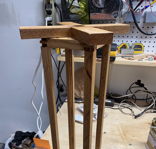

The lamp base is made out of two 1¾” x 10” pieces and fit together with a center lap joint. The lap slots were cut using the table saw in a similar method that was used for cutting out the prongs. Once they fit together, glue them and let it cure. After the glue is cured, drill out a hole and file out a path for the lamp wire to pass through. Position the bottom frame of the lamp in the center of the bases and mount four screws through the plywood into the base boards. Thread the lamp socket base into position on the plywood and then mount that into the plywood and base using the included screws.
With all the material dry fit it should look like the last picture.
