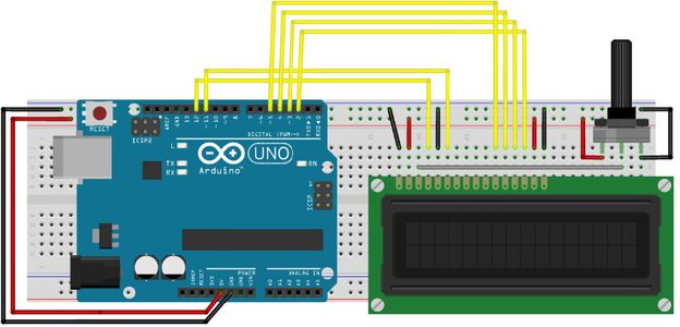

After publishing the previous post, my friend told me there is an easier way with a 10k potentiometer, so I use the potentiometer included in the kit and follow his diagram and did the wiring.......
Step 1: Wiring With Potentiometer
It works! Now I can turn the potentiometer to control the LCD!
