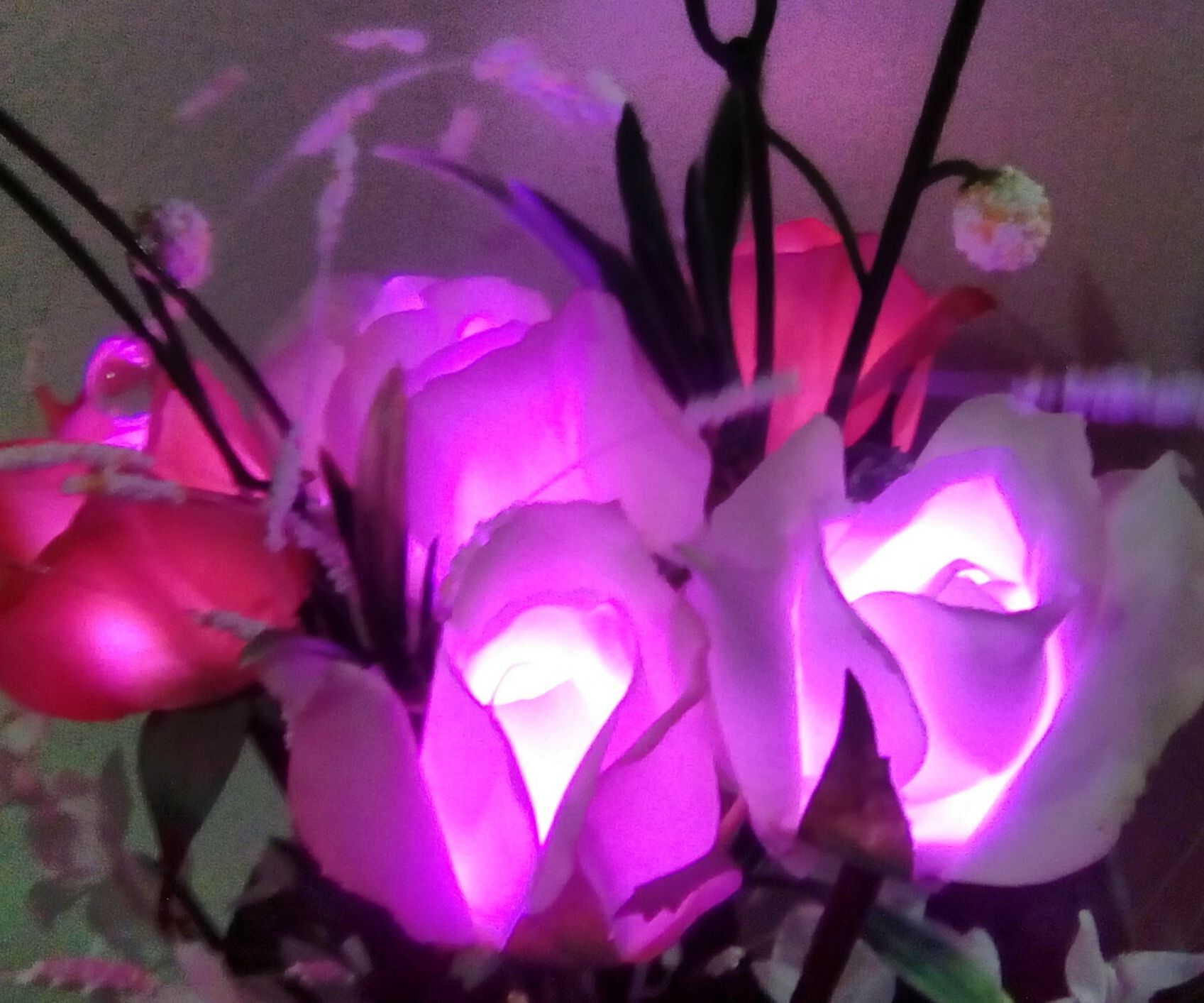

- Can add a bit of something (possibly the plastic "flame"?) around the led before the resin cures, to make the light more diffused throughout the figure. One thing I usually do is snip off the top of the led in the first place, which flattens the top, making the light widen rather than focused. Can buy LEDs with flat tops as well. These as I've shown them will light up walls and ceilings with nice effects because of the shapes on the surface of the figurines.
