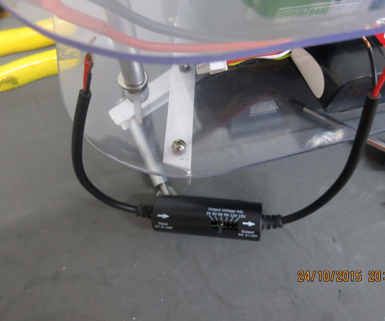

Back on the net and found a Headband Magnifier (under $20), but again the magnifier did not achieve the magnification I required. Down to the local office store and purchased a A4 fresnel (under $6). Cut the centre out of the A4 fresnel to match the internal size of the goggles and then took the magnifier out of the headband magnifier.
Step 2: Goggle Set Up.
Modified one of the original frames that came with the goggle kit to fit and secured the headband magnifier. Installed the magnifier as close to where my eyes were to be and treated them like glasses. With a little trial and error position the fresnel to provide the most clarity when viewing the screen through the magnifier.
Step 3: Modified the Headband to the Goggles
The goggle kit comes with an elasticised strap with a quick release. This also didn't suit me so I modified the headband to the Headband Magnifier to fit the goggles. I just used a trimmer to modify the front part of the headband to the shape of the goggles and taped it to the goggles. I find now the headband adjusts easier than the original and the goggles can be tilted up as the headband pivots.
