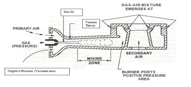

Gas burners use the venturi effect to pre-mix gas with "primary air". The venturi uses the flow from the gas orifice to draw in the right amount of air so it can be delivered to the gas ports where it is burned by the surrounding air (called "secondary air") The primary air mixture in is important. Too little air and you get a yellow flame, soot on your pans and carbon monoxide in your kitchen. Too much air and the mixture can ignite before it on its way to the burner ports, or the flame will blow away from the ports. There are various rules about venturi throat diameter and port area, a well engineered burner has a blue flame and has a high "turndown ratio" (adjustable from a low simmer to high). If you are interested here is a great download.

The picture here is a lot like my old stove. The gas orifice and venturi are under the cooktop and the primary mixture is delivered through several inches of tube.
