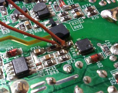

As a matter of fact, a SMPS 110-240 Vac to any DC output will have an optical isolation between controlling and drivers and as well slot cut on the PCB - these are easy to be found on our PCB. Therefore between the output side (place where the DC cable is soldered) and the slot cut on the PCB it should be located our feedback block as well.
On that area are 2 small black bugs and we should read the markings on these 2 electronics components: TEA1761 (2 x 4 pins, SO8 SMD) and DS2xzy (2x3 pins, TSOC SMD)

We need to use the continuity tester from the multimeter and to draw the schematic on paper. Since the feedback voltage is through a voltage divider and the voltage must be precise over time, I assumed that the voltage divider contains the 2 resistors marked with 4 digits (that means improved tolerance).
So eventually I checked the continuity only on the right side of the TEA1761 and I draw the schematic.
Step 5: Tweak the Voltage Divider
Now we know which resistors are part of the voltage divider, so we can replace such fixed resistor with a variable one.
I decided to remove from the board R41 (68k Ohm) and to put instead a variable 100k Ohm resistor connected by 2 wires to the board.
Here comes a dangerous part: need to connect the power supply to the mains (110-240 Vac), this time the power supply is opened and live circuit is exposed! Please pay maximum attention during this operation and avoid touching the board of the power supply!
Rotate the variable resistor, this will modify its value, see where the power supply will stop working
(minimum voltage output) and see where the voltage output is 17 Vdc.
Remove the mains from the power supply and continue.
We should desolder carefully the variable resistor and measure its value for an output voltage of 17 Vdc - I measured around 58k Ohm.
I found a resistor of 56k Ohm around and I soldered on the board. The output voltage is 16.5 Volt, good enough.
