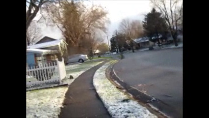

Step 8: Test Footage
Here is some simple test footage from the camera. There are a few things to be aware of with the camera that I used in this project. First of all, I am sorry about the quality. This camera only shoots in 320x240 resolution. Also its white balance is not the best. Also it tends to blur with even the slightest movement. So for best quality, I recommend using shooting with the camera as still as possible and in a well lit room.
