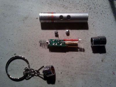

Step 1: Disassembly
First, take the keychain out of the package. Put the batteries aside, you won't be needing them for this anymore.
Unscrew the cap where the chain is. Normally the batteries would go in here. Then hold the barrel so that the buttons are on the bottom and pull the other end off using pliers. The entire assembly should slide out, provided the buttons have settled out of the way. The barrel (which is normally part of the circuit) and the plastic battery retainer inside can be put aside. You should have parts that look like the second picture in this step.
Note that there are some insignificant parts variations on these. The PCBs are either green or blue, and the wire sheath on the LED lead can be red or blue. Neither of these changes anything, even though the PCB trace patterns vary slightly.
